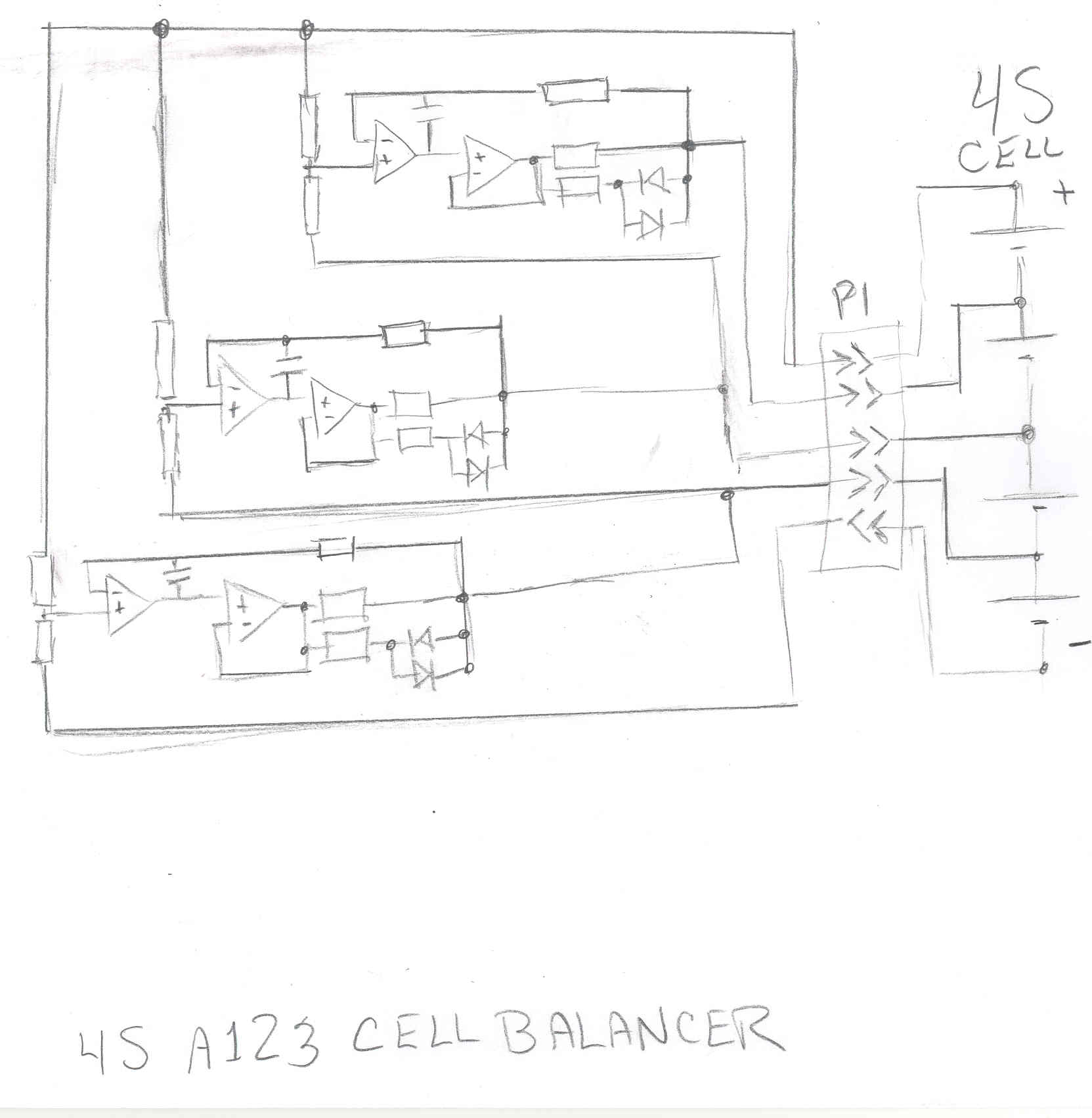

browngbuck, Attached is an outline of a "Cell Balancing" Circuit for the 4S A123 Battery Pack. After you get your Solar Charger completed and you use it for a while you may find that one cell is "lazy". You cannot fix this problem (as discussed earlier) with a Series Charger. This circuit will re-balance all of the cells to within 1/100 of Volt !!! You could even attach the Balancer while your Solar Cell is charging the 4S A123 Pack. The Balancer circuit needs to be removed when the A123 Cells are balanced since the Op-Amps will continuously drain power from the batteries. A123's have low leakage (long shelf life) when disconnected.

BB just to help you on something else, when you draw a schimatic don't draw little bridges over wires, to indicate "no connection", like you have, instead draw a little circle. also draw the circle at your T's
sorry spindrah, i cant take credit for those drawings.... they were copied off websites :(

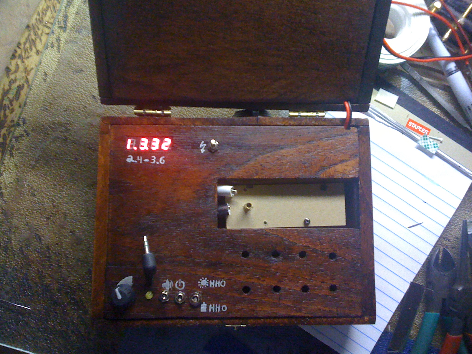

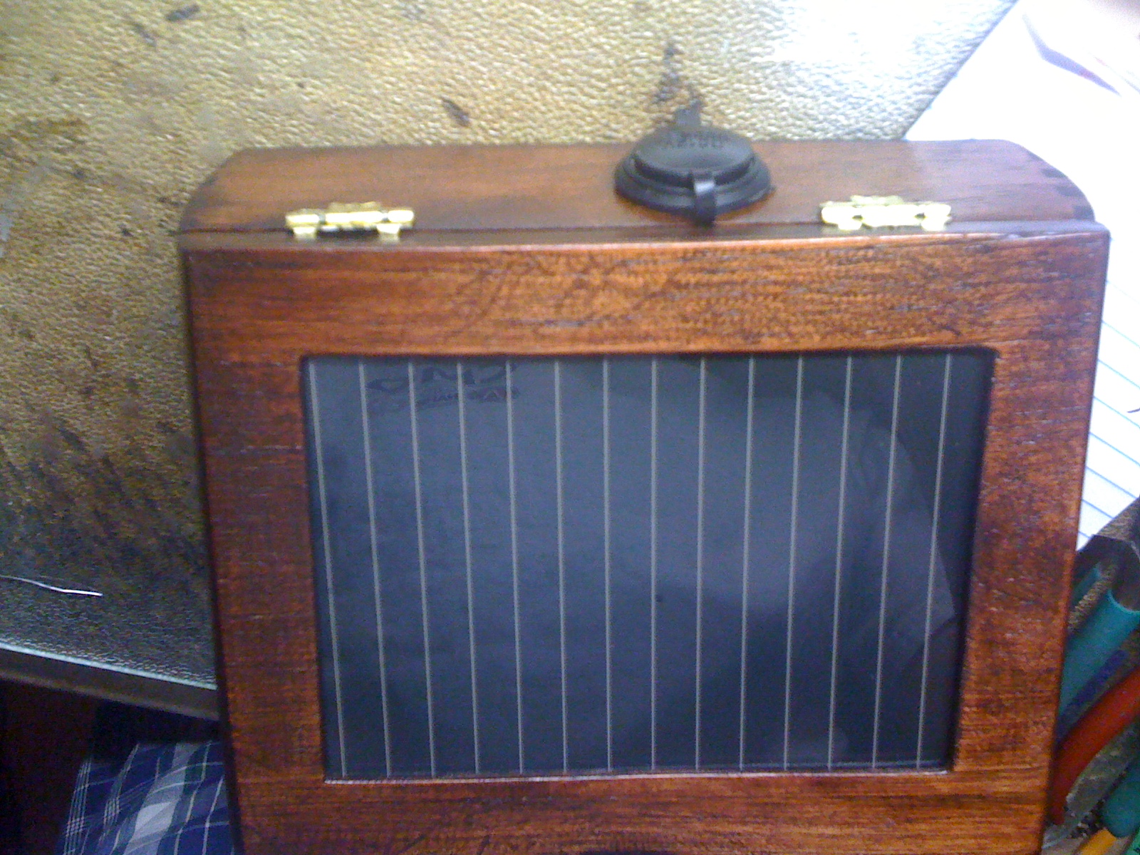

okay guys here is what i finished up last night, my plane leave tomorrow and this is a gift for my dad who is the guy who has everything, it is very much into energy and i thought this was kinda right up his road . like i said its a man toy and it will most likely sit on a desk, so the charging system is wired in to the Power switch and then cell monitoring is on the voltage switch that cycles through with the first number being the cell and the next three being the cells voltage. i know im gunna get flamed for the HHO system, but its just a toy and HHO has some good potential energy(the generator still has all the acrylic protection film on it ) thats why it looks brown. was able to fix the little amp, that powers two speakers. anyway thanks for all your help, i WILL be building the Shunt and adding it in on my next visit in June (but due to time, i will not be able to finish it at the moment, but hes smart enough to run the system where it wont hit critical voltages

This will not work.
For one, 12v is not enough voltage to charge 4x A123 cells. 3V per cell is almost dead.
But the real problem here is the that any boost converter like this designed for a fixed-voltage input will fail on a variable-current-output supply like a solar panel. It will easily fall into an effect where it draws too much current and lowers the panel voltage below the MPP, then to try to generate 12V out from a lower Vin it will increase the current, dropping the Vin lower. It will latch into a state where Vin is very low and produce no significant output.
