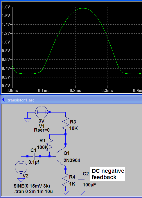

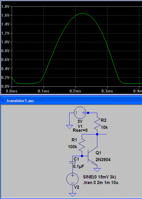

I simulated the preamp transistor in the "garbage" FM transmitter. It is severely distorted with a typical 2N3904 transistor and is worse if the transistor has a high gain. The radio part of the transmitter will drift its frequency all over the place.

The preamp transistor in Aaron Cake's FM transmitter is also severely distorted.
The preamp transistors are not biased properly.
I agree with audioguru, that simple transistor amplifier is crap!
Couldn't you add negative feedback by adding some emitter resistance?
I added an emitter resistor and the gain became reduced and the distortion also became reduced.
Then I bypassed the emitter resistor with a capacitor to eliminate AC negative feedback but keep DC negative feedback but since the transistor is incorrectly biased it still is very distorted.
