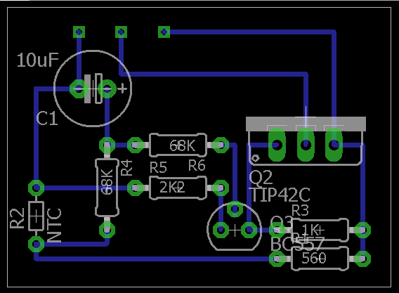

The pads to the external world don't look evenly spaced. May not allow a connector to be used. The pads may be too small.
If this was a commercial board ans even if it wasn't, it's hard to tell which resistor is R5 and R6.
So, move the silk screen stuff a bit:
Center NTC with respect to R2
Move the labels R5 and R6 so you can tell which is which.
The BC557 is way out in right field.
Center R3 and R?
You can move the labels Q2 and TIP41C
I'd use a square PAD on one of the legs of C1 (I can't remember what the common convention is), probably negative. That's the striped side,
I think, "T" corners should be avoided. I think that's an etching issue.
If your etching this yourself, put some sort of label on the component side in copper, so you know what side is up. You don't want to etch a mirror image, Trust me.
One leg of R4 doesn't go anywhere?
Last, but not least. There are no mounting holes.
Thanks a lot. But any problem with T corner? Mounting holes for what? NTC thermistor will be attach to the heatsink directly.
See here: https://electronics.stackexchange.c...reference-for-45-degree-angles-in-pcb-routing point #9.
Really it isn't that important.
The missing trace on the 68K resistor is the most important bug.
OK, so you don't need mounting holes, Consider this scenario. Let's say you place 4 mounting holes in a rectangular pattern. Before stuffing the board, use 4 standoffs. Insert the lowest components while on the standoffs, the turn the board over to solder and clip. They do provide an "extra hand" during assembly and the board is easier to grip when you turn it over. A more complex board might benefit for troubleshooting. Your choice.
Yep, big boards like power amp or preamp with need mounting holes.

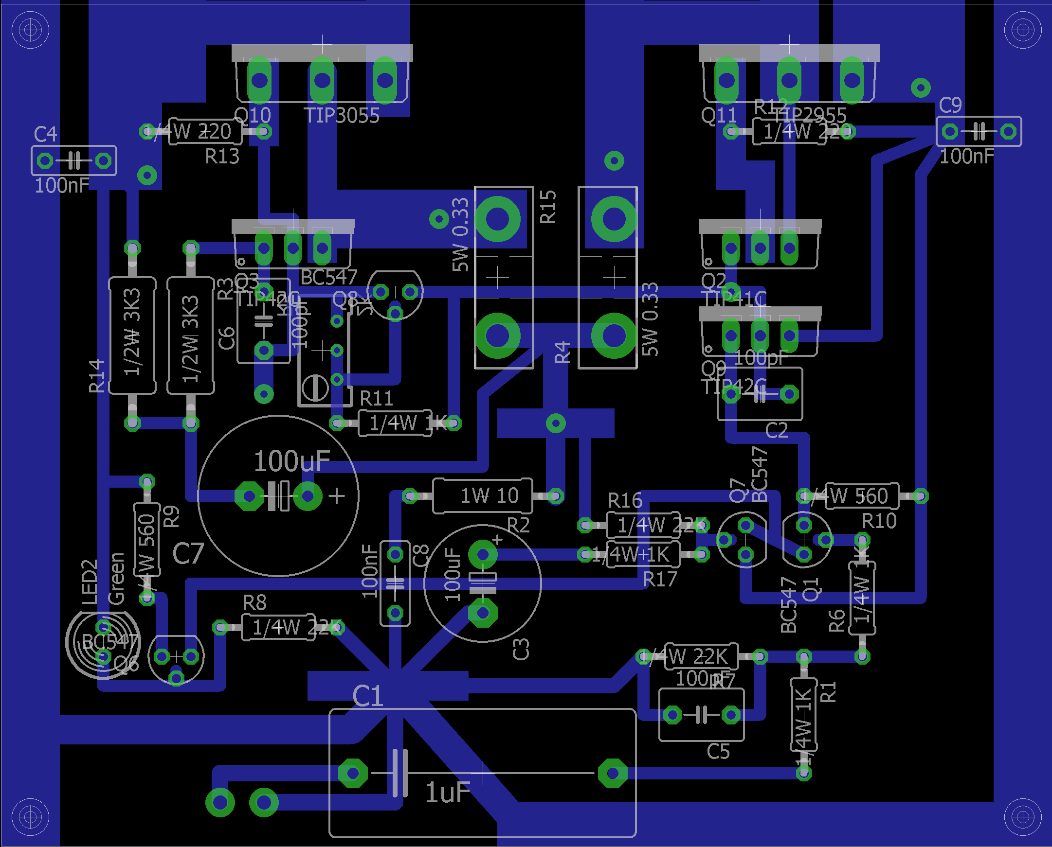

Debugged version:
The space behind TIP42 back is for small heatsink.

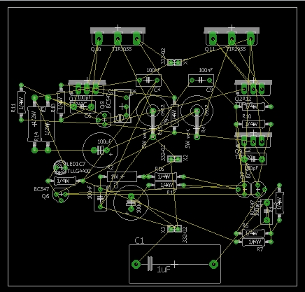

No autorouters, especially in the low end ECAD packages, are pretty dumb.
Yes, I am think so. Only a very simple circuit that I can draw directly to the copper clad board but the program made very dump layout.

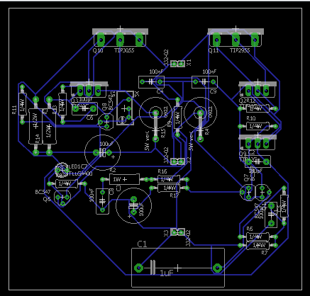

My PCB layout, please point out mistake or given me advices: :)
TIP3055 and TIP2955 just for same pinouts with actually NJW3281 and NJW1302

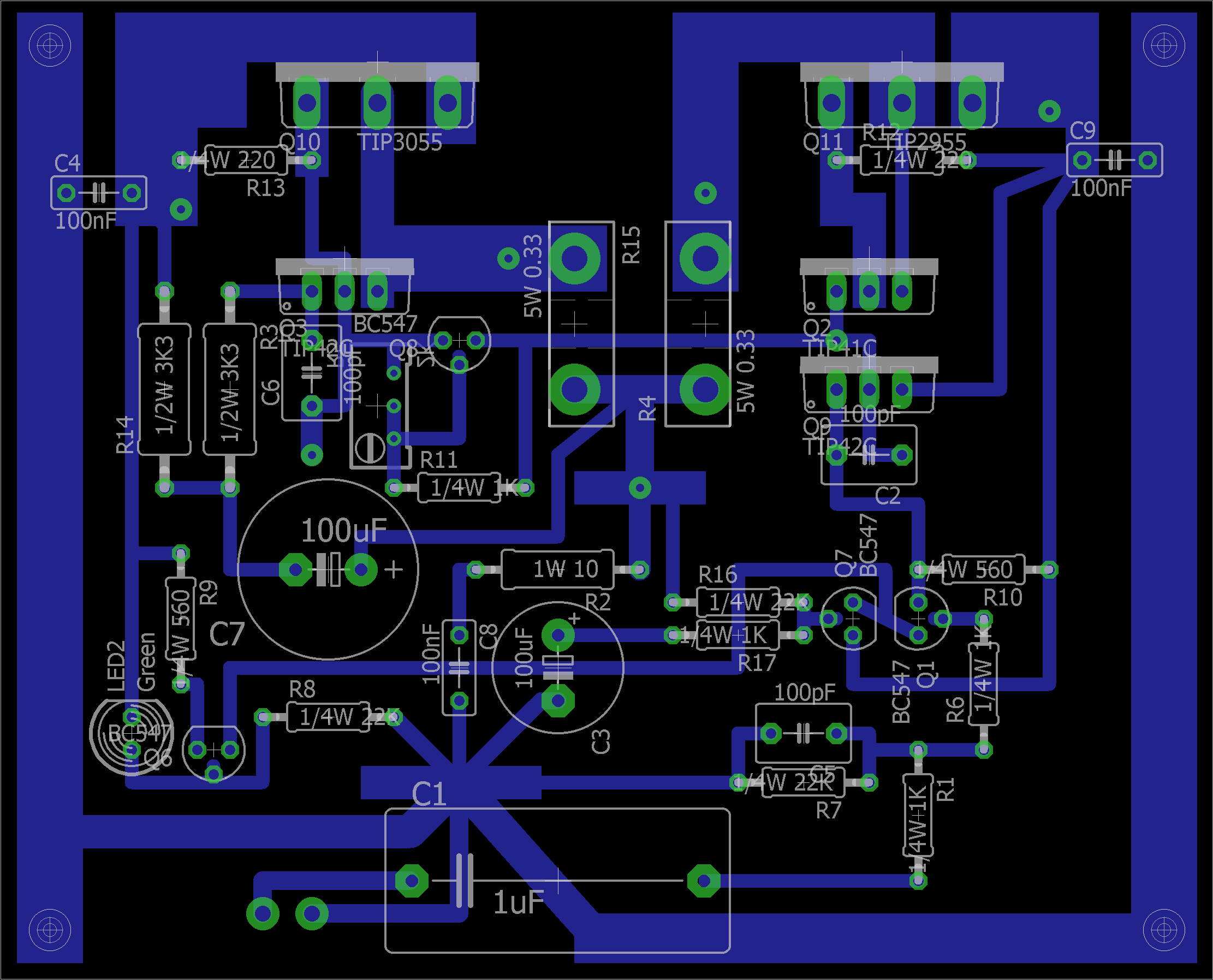

If you were having this made, it probably would not be accepted. The copper should not go to the edge of the board.
Label the inouts, output and + and - supplies.
I found it useful to put an RCA phono connector on my amp board. I also used a pigtail to a Molex connector for power, speaker and ground.
Not sure if the mounting screws being part of the ground is a good idea. It, sort of, defeats the idea of a star ground.
This problem can be solved easily.
I don't need to silk screen printing.
I use this connector in PCB surface:
I don't think it will connect to the chassis, I have PP cylindrical washers.
True. But for your own documentation, it would be worth it.
