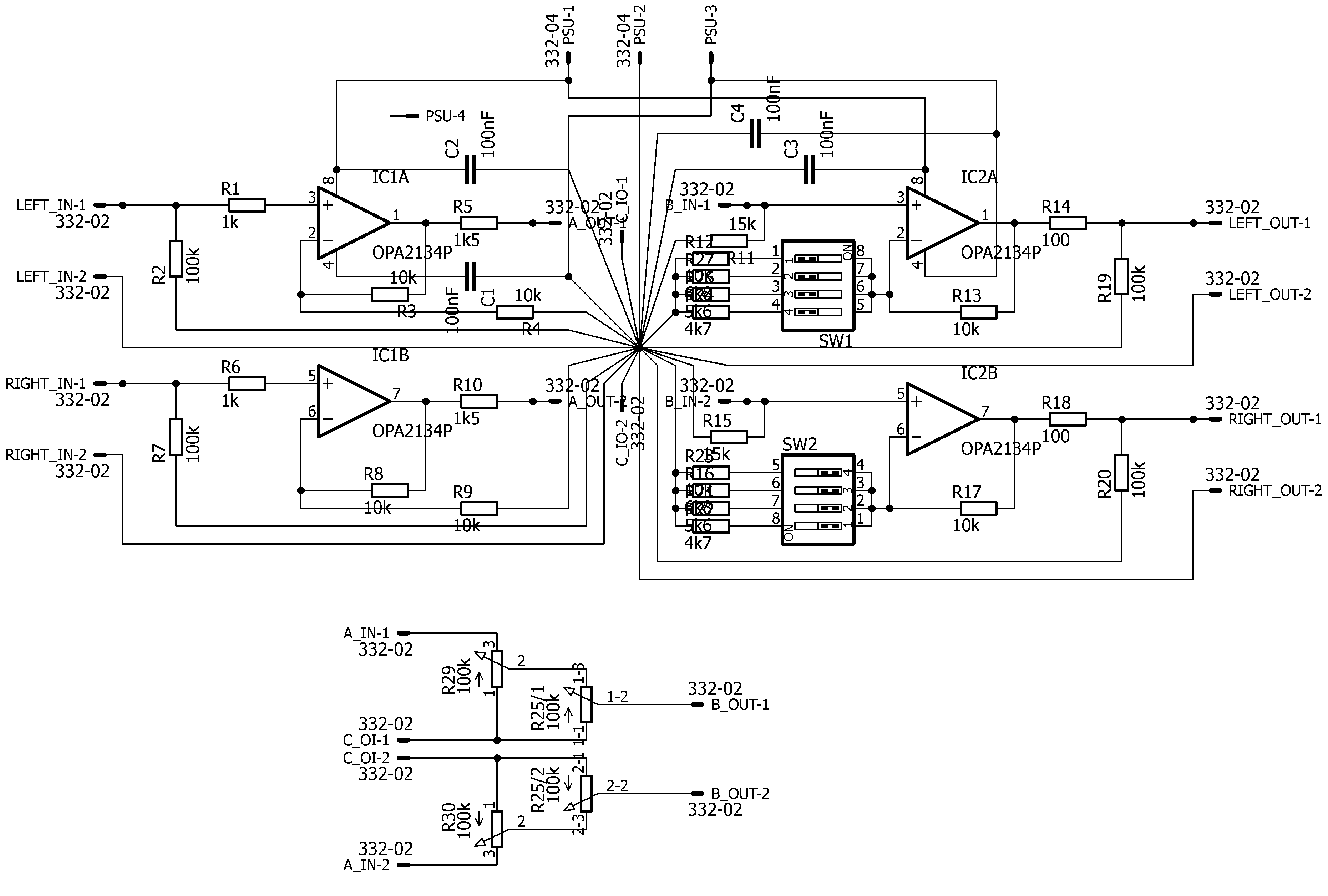

Here is the preamp: The star ground look like a spider web :D
Spiders web looks good:D
In general, nice schematic Nikolai (what software package did you draw that with?)
First thoughts- not checked in detail:
(1) Unless I have misunderstood your schematic, you can remove the first two opamps. The second two will do the job.
(2) What is with the four potentiometers?
(3) Can you list all the inputs and input voltages?

I use Eagle 7.6 Pro :D, export image in monochrome mode because I think monochrome give more convenience to see.
(1) As you know, the preamp was steal from Elliot P88 fully :D, except all capacitors have been kicked out :D. I think use only one gain stage will be fine, but should have compensate for -6dB on the crossover.
(2) The first two pot will act like balance control, I like to control like this, not like use one pot between two channel with middle terminal connected to the ground :p. The scond two pot is part of dual pot which is master volume control.
(3) - CD or DVD player (max 3V RMS)
- TV audio out; computer, mobile phone audio out............ (max 2V RMS)
- Mixed: 2X CD audio out, 2X TV or computer audio out, 2x microphones
- Phono preamp will be separately, phono preamp out will feed CD player input.
Any problem?
Not sure what you mean. The opamp frequency response will be flat from DC to well beyond 20 KHz.
Good about not using a single pot. Are the first two pots (balance) separate pots with their own knobs?
100K pots look a bit high. 10K would be more normal to keep the noise down.

But on the schematic there is only two inputs to the preamp: left in and right in.
I can't read the values of the gain changing resitors
How are you mixing the signals. I can't see that on the circuit.
I would advise normalizing all your inputs to one voltage level (300mV RMS?) rather than switching the amp feedback (always dangerous). Some of the input signals are too high anyway.
The input to the power amp is 1V RMS, if I remember correctly, so all you will need is a x3 opamp circuit.
I didn't put the dual 3-throw selector in the circuit.
The values is hided by other resistors: 4k7, 5k6, 6k8, 10k
I haven't drawn the mixer yet.

Why need even 3 opamp circuit?
No, I mean signal strength will loss 6dB after pass through 2nd-order Linkwitz-Riley filter. So in preamp stage, gain should compensate this loss.
Got it- changing the gain of the preamp is no big deal: just one resistor change.

How about having a push button switch or any two pole 1 way switch for each input. That way you could mix and match any possible combination of inputs and have a simple circuit. Be a novel approach too and could be made to look pretty cool with blue LED indicators for each input. :cool:
It would be a help to move the values so I can see them . The schematic should always be Xtal clear and as complete as possible. It saves people spending a long time trying to figure what is going on. :wideyed:

The input voltage is maxium 2V RMS, but in normal listening, I think is only few hundred mV.
You always go by maximum voltage to get maximum power from amplifier. 1V RMS is pretty standard as far as I can remember. It is also a good value for a power amp input voltage for maximum output. The gain can be changed by changing one resistor in the power amplifier
You really need a low and constant impedance to drive the power amplifier.
Coooool! Sometime I put my head into the bush. :facepalm:
I will do.
Change resistor in preamp will be easier.

It is better to make the input to the power amp 1V RMS. You need to make sure you maximize your headroom (before clipping) but either way it does not matter much
Here is an outline schematic illustrating the topology I strongly recommend for your preamp. It only has rough order of magnitude values and decoupling etc have been left out (note use of monochrome as advised by NP :)).

(1) Chang R10 and R1 to 47 Ohms
So simple, I like it. :cool:
Resistor in each input I think will be 4k7 or 10k. How many gain at second stage? (I don't know how to calculate gain with NF path like that)
Problem: WIMA don't have 1% cap big enough to use in crossover :arghh:. The biggest is 0.033uF, so resistor is 47k (cause current hungry).
Good. It is a pretty standard topology
I would nor worry about resistor values- this is just an outline schematic.
Yes you do.Voltage Gain of second stage is 1+(R1/Infinity)= 1 :happy:
1% is not necessary 5% will be OK and possibly looser. Again don't worry about details for the moment.
