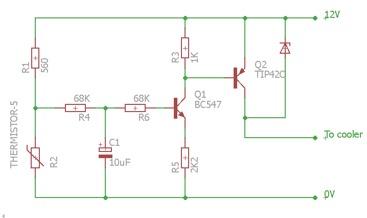

Cooler speed controller using NTC-MF52AT 10K:
As @AGuru said your NTC control is wrong direction. Also Resistor values are too high to guarantee tight regulation, and saturation of output stage.
I changed all values for many reasons,. The cap also serves to pulse the fan on power up.
It works for NTC from 7K to 5KΩ which keeps it cooler with tighter regulation. YOu can make small adjustments to Re for start temp but 1K is too large when PNP saturates hFE approaches 10 and cannot drive full speed.

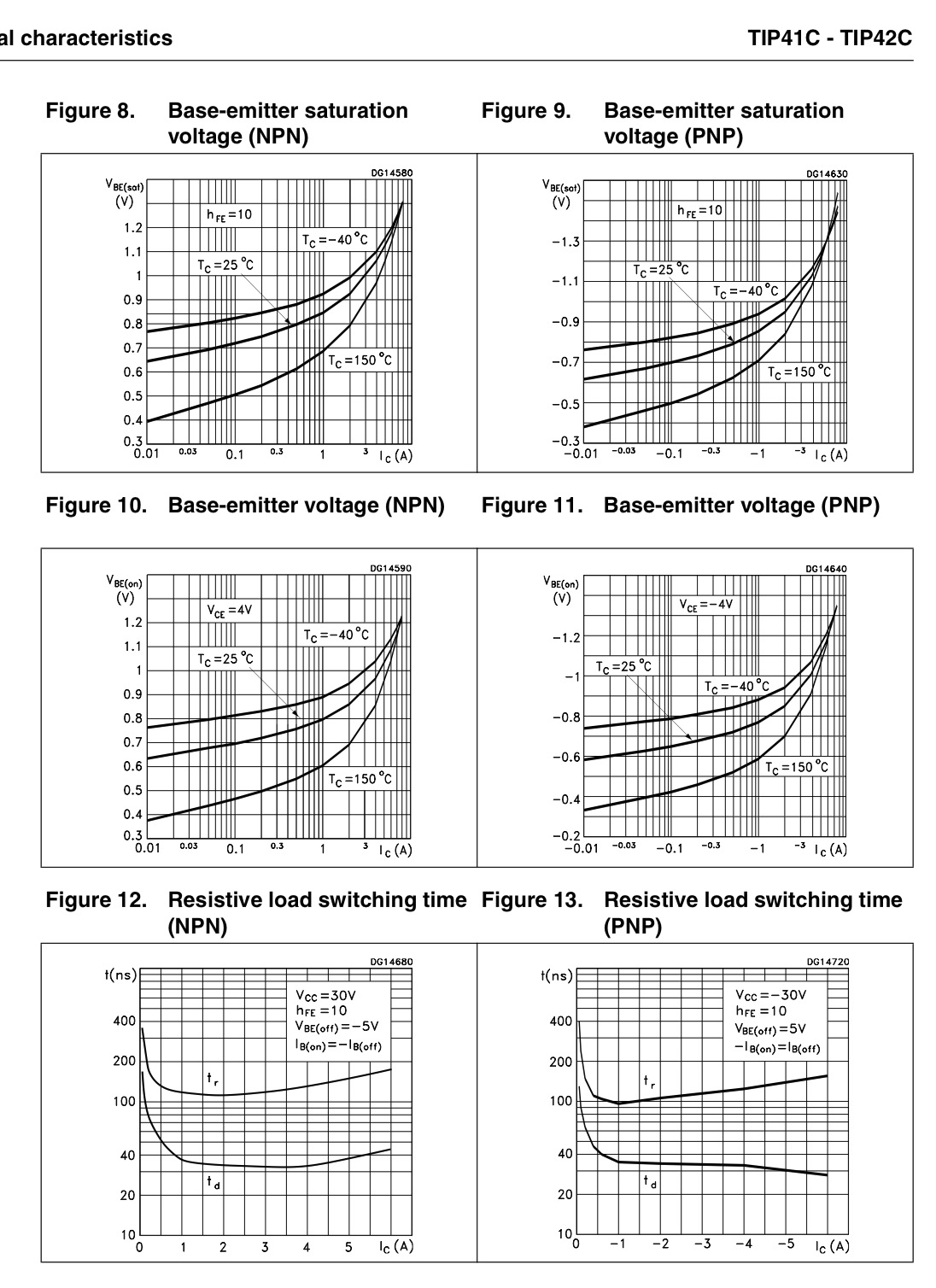

Ideally Q5 is thermally mounted with Q6,7 for compensation, or thermistor can be used.
The Vbe which affects output bias is from drivers Q6,Q7.
For reference there are graphs on Q8,9 which you can compute ESR at worst case hot currents from incremental slope of delta V/ delta I. At Ic:Ib=10:1 and Ic=3A, at Tj=150'C, PNP Rbe~0.1Ω which means DF is now 23*4Ω/0.43= 213 ok but excluding ESR of Vcc and speaker wires. ...which is why beefy litz wire is best for speakers for bass response.

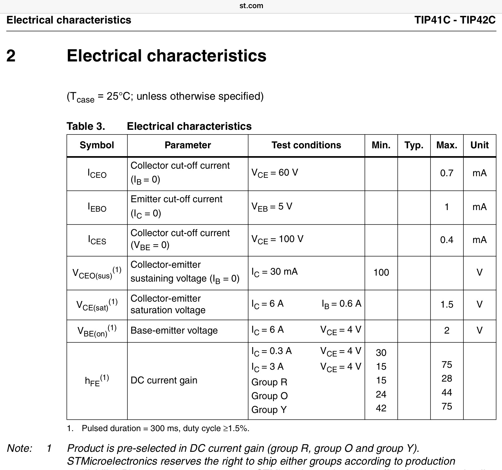

Sorry but TIP41C/TIP42C aren't my choice.
Regardless of Transistor , you ignored the other characteristics, unless you take care with ESR on each part, your DF will cumulatively degrade from theoretical max defined.
