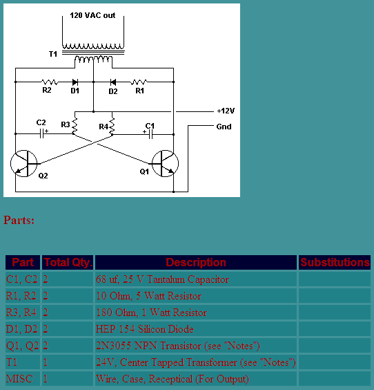

This inverter circuit is garbage. It should be burned.
Its capacitors are backwards so they blow up, its transistors have avalanche breakdown of their reverse-biased emitter-base junctions (which creates a very high current in the backwards capacitors) and the transistors don't have anywhere near enough base current for any power output. It gives an output of about 25W at a reduced voltage, just before the capacitors blow up:

Another fine circuit from the world of Aroncake.
