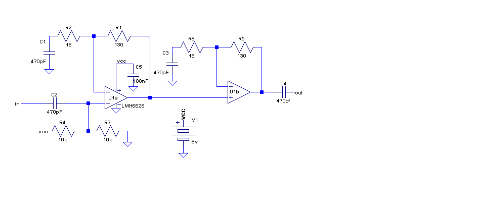

How can i implement a circuit for amplifier an ac signal of 50Mhz and 60mV to a signal of 5volts? Can i do it with transistors or maybe with operational amplifier? Can anyone says me the exactly circuit for this signal? thanks a lot
you need a gain of 50/.06 = 83.3. Multiply this by 50 mHz and the result is 4.2gHz gain-bandwidth product. You won't find an op amp with that spec, so you will have to build it discrete. If the signal is narrow band, you can use tuned circuits but if it is wide band, some kind of R-C stage will be required.
the R-C requerired is before the amplifier? Can you say me the complete circuit, please? thanks. the transistor to use doesn't matter?
I am modulling a bpsk with 50 Mhz, then the amplifier must work centered at this frequency and with a bandwidth of 10 or 20 Mhz. Is it possible? How is the circuit? thanks

If so, you need a comparator. Take a look at Linear Technology's LTC1715. This should work for you.
This should work. The supply voltage has to be 10 volts or less. You could use +/-5V, which would allow you to eliminate the bias divider on the input. The high side bandwidth is over 200MHz, which might be a problem.
The LMH6626 is a dual current feedback amplifier. Layout needs to be very tight, using SMT components and a good ground plane. Stray capacitance on the inverting inputs can cause stability or frequency response problems. The resistor values are not arbitrary. Current feedback amplifiers are very sensitive to feedback component values.
