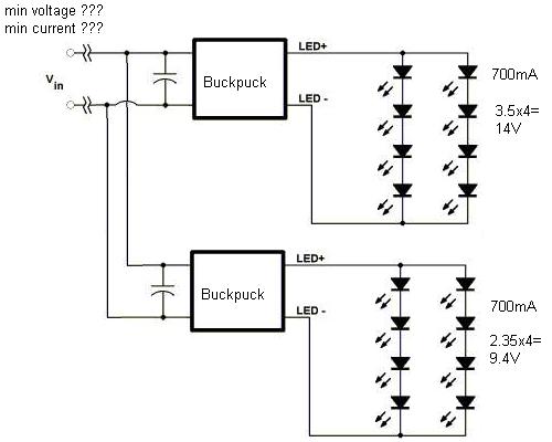

The input voltage I was looking at is either 12 or 24 since I'm not sure how many LEDs I can hook up yet. This specific 12V model I was looking at is 18W so 750mA. The LEDs all pull 700mA. I did some more reading since I posted this and found out what Chippie said that you have to add the mA for each series to get the total draw.
I'm more concerned with the two pucks (output whatever the voltage needed at 700mA. I didn't see anywhere the input current specification so I'm assuming it will draw as much as it needs up to the max the AC adapter will put out... and that is what I'm worried about. If I hook the AC adapter to two pucks, how do I calculate the draw since there are two different voltages? I can add all the amps together to see if that is fine but what about the voltage? Do I add the voltage 3.5 and 2.35 together?

I don't mean to be confusing so I attached the schematic and thank you for your patience.

But back to the question. In the diagram, how would I figure the minimum voltage/current needed by all pucks?

Easy, just add 2V onto the total LED voltage drops, so for the 14V and 9.4V you need a minimum of 16V and 11.4V respectively.
The LEDs will probably not completely matched so they won't share the current equally. Although connecting them as strings of many helps, you may need current balancing resistors to help split the current.

In writing my response I just figured this out. For the example I would use at least a 16V AC adapter. The two pucks could be considered a parallel circuit and therefore the voltage is the same for both branches. Since each puck produces 700mA I will assume it also draws that much (I agree that this is probably not the case, but I will be generous just to be sure) which means the AC adapter will have to output at least 1400mA because the current rating for each branch of a parallel circuit are added. Using the rule Watts=Amps.Volts I would require a 16V 22.4W AC adapter.
