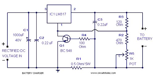

I found this circuit, but it charges at 2.2A max. Is it possible to use more of the LM315 s in parallel to get higher amps.
Read "how to charge lead sealed acid batteries" on this page. This applies to flooded lead acid batteries, too.
Something like that circuit would work. It won't be super fast to charge but since its for backup it probably doesn't matter. So should we try to come up with one like above but for 11 amps maximum charge current or are all your batteries in parallel?
The circuit shown protects the batteries by making the maximum voltage 13.6 volts. They won't overcharge at that voltage.

880AH?
Charging them at C/10 would mean 88 amps of DC current.
This will not be achieved with a simple LM317 circuit, you cannot parallel that many.
Large battery chargers always use SCRs as the power control elements. I had a schematic for such a large charger somewhere. Let me see if I can find it.
