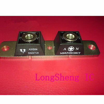

Hello, i salvaged a transformer from my old microwave, among other things. Since i got a spare spot welding board i thought i could power it with the transformer. The problem is that the board obviously requires DC, i was shooting for enough windings to get around 12V.
What would be the easiest way to convert AC to DC, preferably using the spare parts i got laying around from old power supplies.
The rectifier would have to be built out of something like these:
Paralleling the two diodes in a module makes it capable of 400A (on a good heatsink).
Four such modules in a bridge could take 800A continuous, or rather more in short pulses.

Smaller 20A diodes are dirt cheap though, 50pcs for few bucks. Could i just parallel a bunch of them and add some heatsink with a fan ? I don't expect i will need more than 200A to spot weld 0.2, and its miliseconds of current going through for each weld
