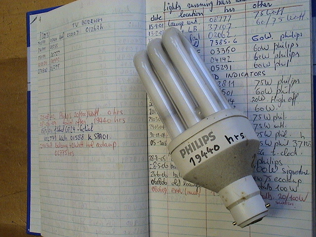

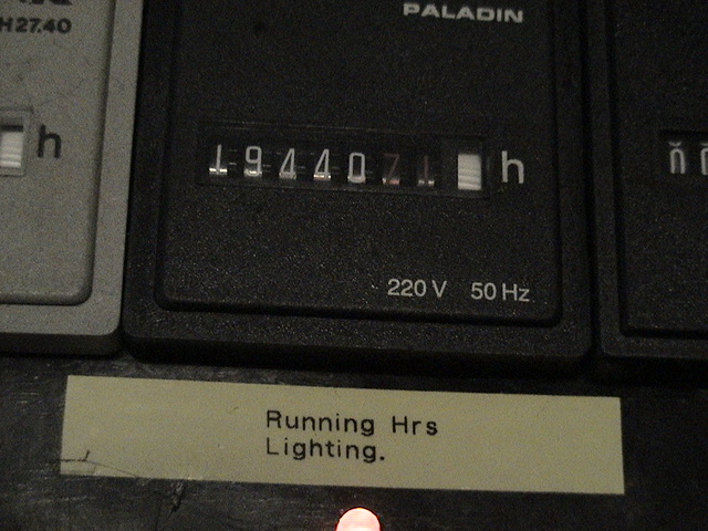

CFL's do last very long, my first Philips CSL failed after 18000 hours. (not bad)
Not good at all, demand your money back.
What manufacturer ?
Philips CFL
Photo's attached.
It was actually even more, 19440 hours
not bad at all.
What manufacturer ?
I bought twin-pack of them last time I was in Spain, the other one hasn't failed. Anyway I feel better putting the word IKEA in bigger letters.
Probably made in China, the cheapest, like most all of ikea stuff.
