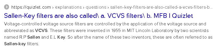

Sallen-Key topology
The Sallen–Key topology is an electronic filter topology used to implement second-order active filters that is particularly valued for its simplicity. It is a degenerate form of a voltage-controlled voltage-source filter topology.
S & K were the inventors in 1955 :
OpAmps invented 1952 - https://www.computerhistory.org/revolution/analog-computers/3/156
