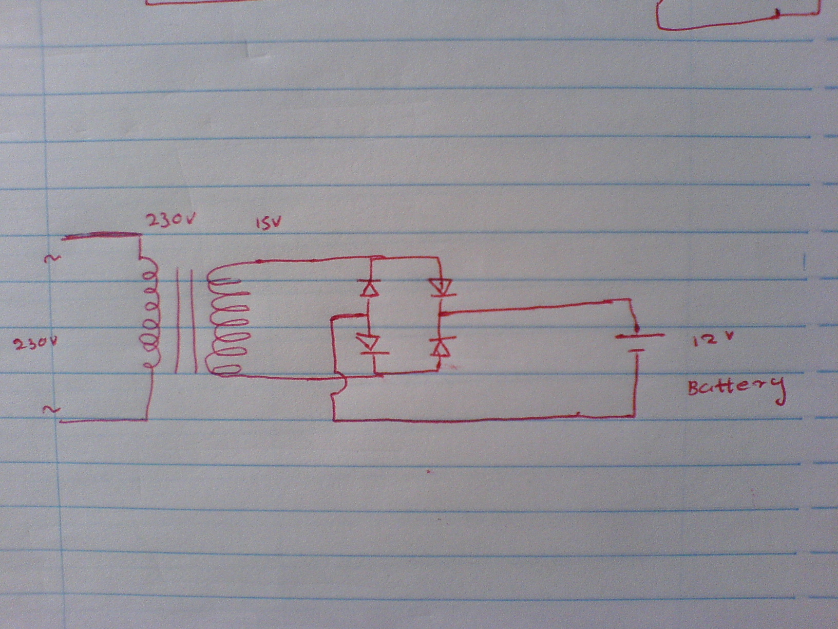

guys I'm using following circuit to charge my 12V 1500mAh NiMH battery.(with 230V --> 15v step down transformer and a rectifier bridge)
is there any way i can put a indicator led or something to indicate charge complete status? (very simple circuit will be great).i was thinking if i put a series LED with battery will it go off once battery is fully charged?
thanks

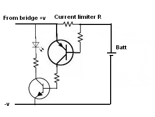

That doesn't look like a charger. You need to control the charging current by using a series resistor wrt the battery specifications and transformer output
Voltage drop across the resistor can be used to switch ON a transistor to indicate the charging process. I think the series LED will do the job at least.
EDIT: Attached a reference figure :)

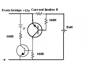

That depends on transformer current ratings.
Suppose, for a 750mA transformer, 750/10R=75mA you'll get as constant charging current if you apply 10R limiter resistor.
So 1500mAh/75mA = 20hrs time for topping up the battery(approx.!)
Refer the new image for rest of the values :p and feel free to experiment of it and let me know :D

thanks I'll let you know.

transformer i use is (7.5V-0V-7.5V 300mA) one. i use it as 15 v transformer(by removing center tap) .so is that mean i get 15V 300mA from it?
Are you trying to build a bomb? :rolleyes:
NiMH batteries don't like overvoltage! :eek:
15V out of the transformer results in close to 20V when using a bridge rectifier (or four single diodes wired as bridge rectifier) at nominal current. As the battery gets fully charged the current decreases and the voltage rises to the idle voltage of the transformer which is normally 1.3 to 1.4 times the nominal voltage. It means the voltage will increase to 28.3V at zero current.
You'd be better off using a MAX712 to charge the batteries properly. It can be (wire) programmed for 1 to 16 NiMH cells. The MAX712 terminates charging when detecting zero voltage slope.
