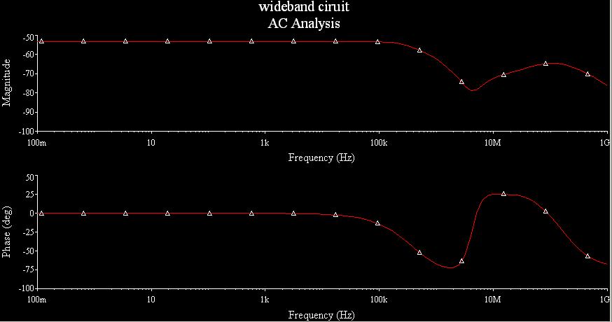

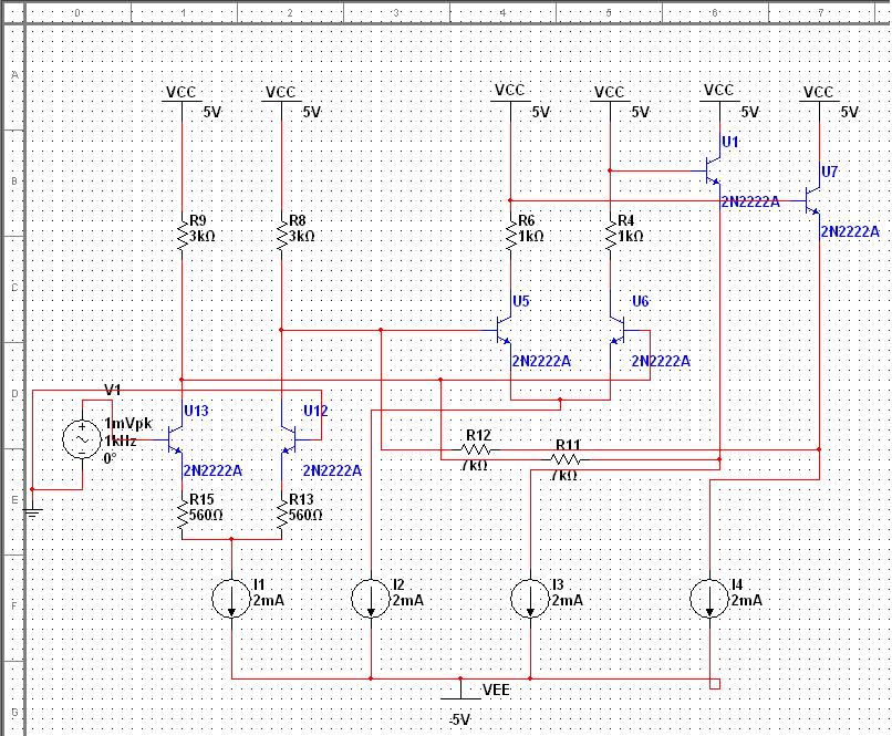

1. For the 60 db, Av= 1000, the circuit is shown in picture 2 ( attached ) and the AC analysis is attached in picture 4
2. For the feedback, Av= 10, and the circuit is shown in picture 3, and the AC analysis is attached in picture 5..
I didn't use the values you told me about but we have added at the output a resistor with a capacitor to change the gain to 1000, is that right?
Will that satisfy the frequency requirement of 500Hz?

Formulating a response ATT. Be patient with me.
Where to begin...
Having read your prof's assignment carefully, it was clear to me that he was asking your class (level 300?) to build/design an op amp from discretes, which I hinted at in my first post. After looking at your sim results, it appears that you have not understood the assignment or the definitions of the parameters involved.
Don't be disheartened, or discouraged as this is common for students at this stage. I'll try to steer you in the right direction, but will not give you the complete solution; that, I perceive is not the function of this forum. And be patient, as I do need some time for my beer and chat in my dotage.
1. Look up the terms response curve, bandwidth, corner frequency, junction capacitance, roll-off and the differences between optimized virtual xistors and real world xistors, et al.
2. Now look at your response curves. Does it display any roll-off at either 500Hz or 100KHz? I see the bandwidth far, far beyond the specified limits.
3. With the assumption your prof was asking you to design an equivalent of the uA741 op amp with discrete components sans differential compensation with an optimized matched differential pair, do you not think it necessary to look at the limiting parameters of that device? HINT! I could be wrong, but...
4. Now look at your sim recorded values. What is Av in the one on the far right? I calculate ~1000 per the scaling. I also see that the frequency at that point is 500Hz. That is the corner and should be at –3db or at .707 of the in band voltage.
You have more work to do.

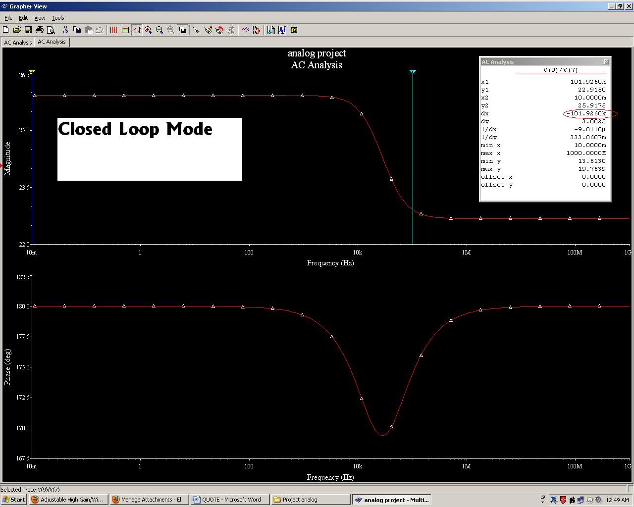

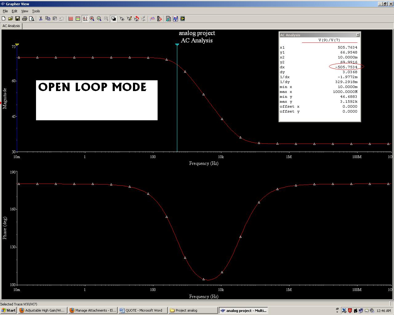

Okay, thanks. I guess I was in the right track this time, since I got my bandwidth around 505 Hz for open loop mode; the gain is 70 dB.
Then I have added a resistor as a feed back... so the gain has decreased but still more than 20 dB and the bandwidth has increased to almost a 101 kHz.
I just need you to check my circuit. If everything is right... my last step is to find the input/output resistances and see if they meet the criteria.. ∫∫∫∞
I don't know about those gain and phase plots. They correlate very closely to what one could expect on the input of a bipolar amp given varying drives for both conditions rather than the output. The phase plot is a dead give away for something not being normal, and then the gain plot just isn't right. The gain down 30 some db @ 1Ghz? Does that seem right to you?
But you have not provided enough data to make a full evaluation; one of those niggling details I referred to earlier. At a minimum, the input level of the sweep as well as the output should be overlaid on the same plot to display the actual gain. If you could post your schematic including the feedback and the phase/frequency compensation components marked as such, I would have a better idea what is occurring with your design.
