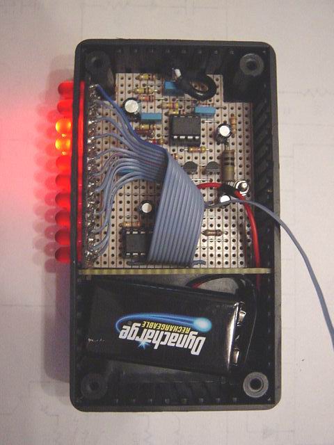

I have a Sound Level Indicator project. It uses an LM3915 driving 20 bright LEDs in 10 steps that have a dimming pot. It has a peak detector circuit. I added 20dB worth of automatic gain control so that it displays a pin dropped on the floor of the next room if there is no other sounds and if I hold my breath, and it clearly shows loud music. Therefore its range in levels is 50dB.
It has a rechargeable 9V battery (actually 7.2V) plus a wall-wart power supply.
