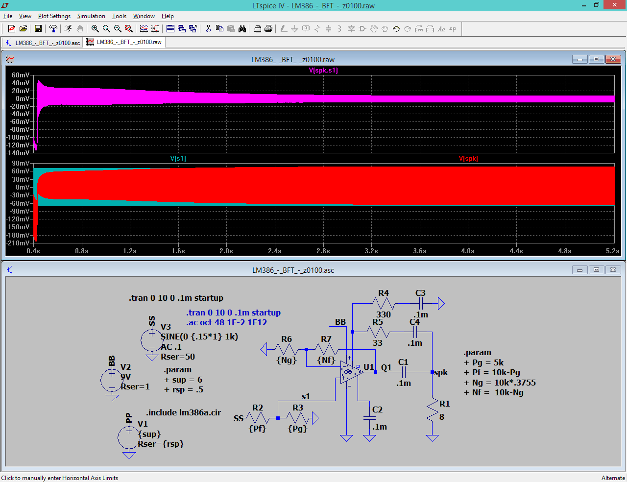

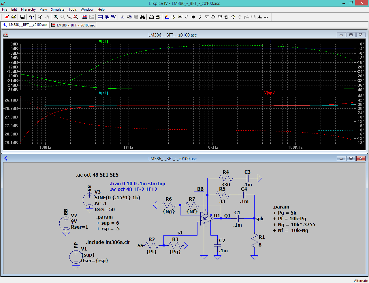

the lm386 has also on chip gain control : **broken link removed**
If the gain is less than about 9 times then the LM386 oscillates at a high frequency because it is de-compensated so that when its gain is high then high audio frequencies are not attenuated.
It is odd that the Japanese company shows BANG-muting by shorting pin 7 to ground. It isn't a little POP, it is an explosion that also occurs when that kind of muting is turned off. I would be better to ramp the voltage at pin 7 down then ramp it back up.
like that ? - i mean - i cannot set up the high frequency osc. cir. you hint exists
in attempt to find one i came across of this ??? http://www.rexresearch.com/flanagan/flanagan2.html
back to stability -- has a hint of simply ac shorting the pins 1 & 5 . . . (busy) . . .
it looks we have your signal !!!

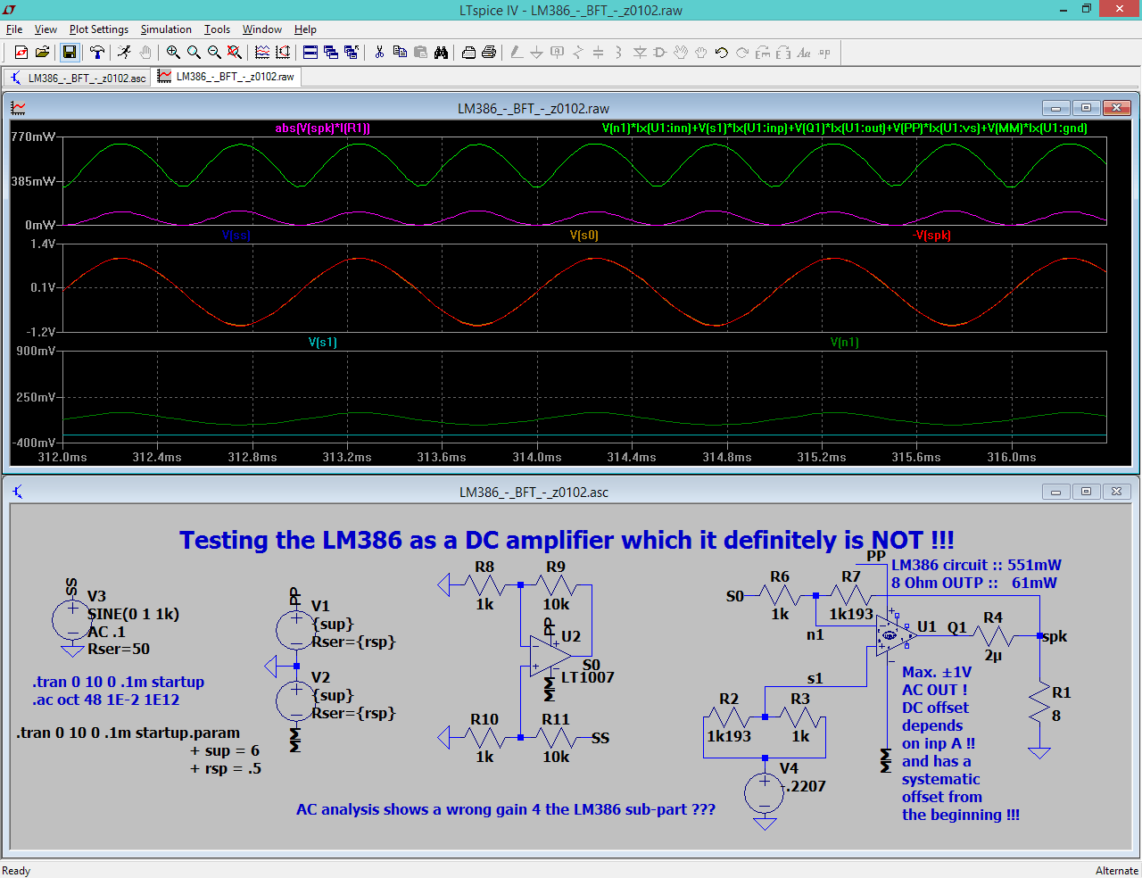

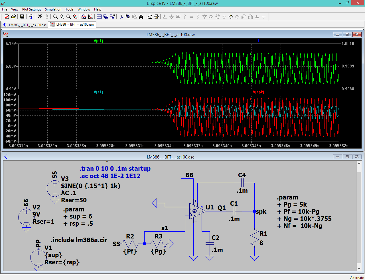

did some experiments /!\ what it's worth :
Why does your simulated LM386 circuit have so many parts? The bass boost circuit in the datasheet reduces the gain of mid and high frequencies to a little more than 9 times with one resistor and one capacitor.

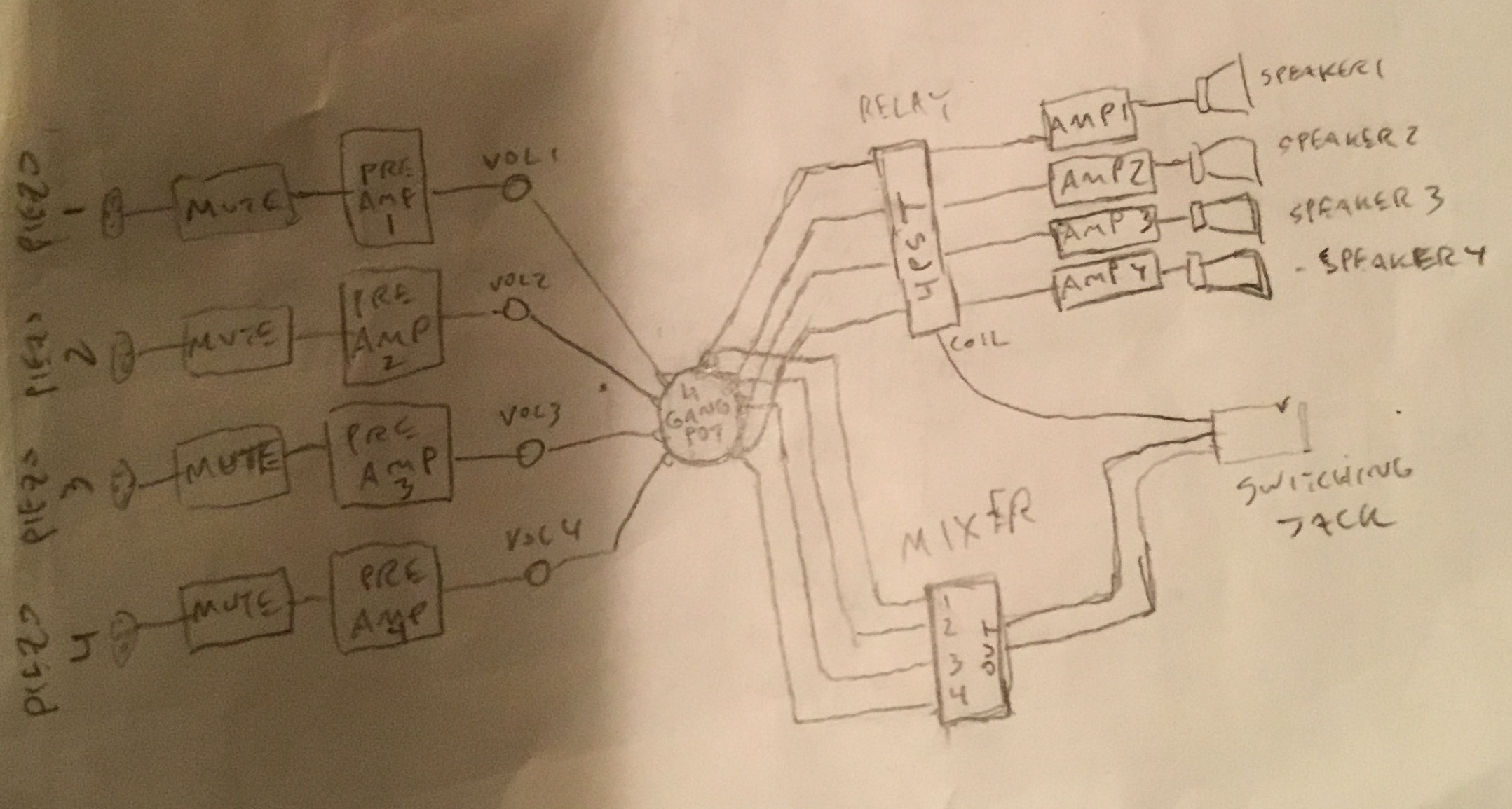

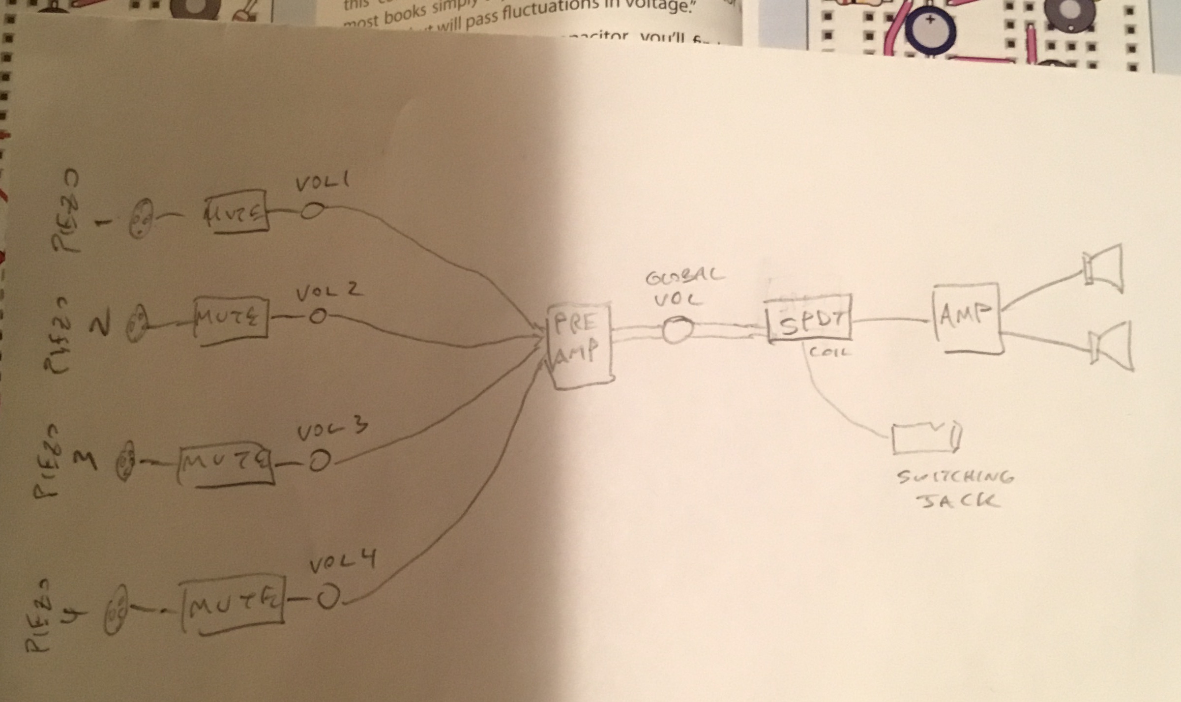

So in my spare time I think I have come up with a serviceable block diagram. Before I move ahead with prototyping it, I wanted to ask about possibly simplifying my plan.
Your suggestion calls for mics>mutes>preamps>individual volume controls>etc. Part of the complication of this circuit was the requirement that each mic feed its own speaker, unless something was plugged into the switching jack.
What if I instead combine the 4 mics into a stereo signal? I believe this would require a much simpler layout. I have read that you can feed 4 piezos into a single preamp without much signal degradation. If this is true, and if it would work moving the individual volume controls before the preamp, then I believe this would work:
4 piezos>4 mute buttons>4 individual volume controls>preamp>global volume control>SPDT relay>amp>stereo pair
Then the switching jack would be connected to the SPDT relay coil
Even if I need 4 preamps, it still seems like this would be a less involved circuit, as only one amp and no mixer is required.
I have attached a couple drawings below. Could you please let me know if the diagram for my original idea looks like it's on the right track, and also whether my simplification seems workable?
Thank you!
