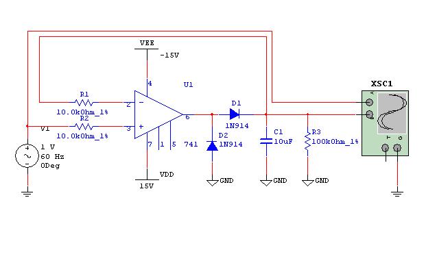

Could you post a schematic of the circuit you've already tried?
This is the diagram i'd simulated before i try building it..

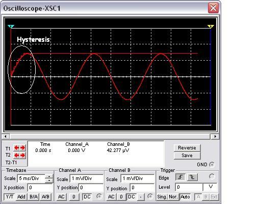

As i'd mention, i tried peak detector but it seems not appropriate for low voltages (in mV)... and yet the Schimitt Trigger is not responding to what i want (the peak of squared wave should be the same with the input signal)
The components availability is kinda problem to me now. Hence, I'm using some of the common devices such as opamp 741.

The old 741 opamp is nearly the slowest opamp available.
The 10uF filter capacitor will take "all day" to charge from the low output current of the opamp.
Use a fast opamp like a TL081 , increase the value of the 100k discharge resistor and reduce the value of the filter capacitor.
Or the opamp could drive a transistor emitter-follower to quickly charge the capacitor with a high current. The signal must be 5V or less to avoid reverse breakdown of the transistor's emitter-base. The base-emitter becomes the rectifier.

Somehow, if i decreased the input signal to few mV, the output signal seems to be 'clamped' above.
Thats what a peak detector does. It charges the capacitor very quickly for its "attack time" then discharges the capacitor slowly for its "release time". The 100k or 1M resistor controls the release time if the input resistance of the ADC is much higher.

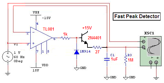

Here is a fast peak detector circuit:

May God Bless!
At last many of thorns in my brain had been unplucked. I'll carry on the work with the ideas. Hopefully the could works with my small voltages!:D

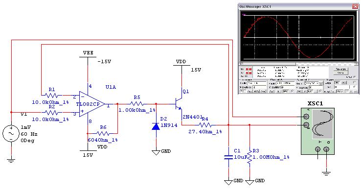

Your small voltage problem could be caused by the input offset voltage of opamps. It is 10mV max. It can be nulled if you add an offset adj. pot to pins 1 and 8 of the opamp as shown in its datasheet.

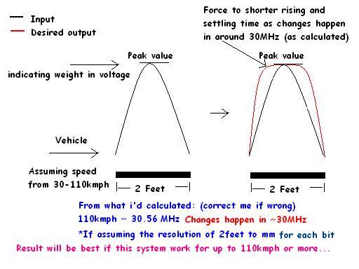

Attached information of my project

Hi Nigel,
Sorry that i'd miss out some information here.:eek: I'd attached a file here on what actually i'm doing and had calculated. From what i'd calculated, it seems like the A2D conversion speed is not fast enough for the optimum result of my project. The signal came from a load cell of a platform and i'm to calculate the axle weigh automatically.
Well, its better for me to be silly now than for the rest of my life. :rolleyes: I have something which i'm not very sure is whether will the A2D perform continuously for the 877A? If so, is it the matter of programming to know the peak of the value? (such as by subtracting again and again to get -ve value to know that the previous is the peak - highest value). Or is there any other recommendation? This seems to delayed the performance.
Anyway.. do correct me if i've done any mistake here as it's the first time i'm using 877A and its function pratically. Thanks alot everyone!:DSignal.JPG
I'd tried using TL082CP for simulation. And now i got a low voltage. Somehow, if the voltage is varying from 0.1mV to 1or2mV, we have to re-adjust the resistor (connected to pin 1 and 8) again. i think i gonna make sure which voltage happens the most so that the thing could work nicely and automatically (without readjusting resistor)

Well that's a VERY confusing collection of metric and imperial figures?. But I'm rather baffled where you figures come from?
110kmph is 30.55m/s - so to travel 1m takes 1/30th of a second (33mS). I'm not messing about with metres and feet, so 1/2m will take around 16/17mS.
This gives you 16mS or so to take as many readings as you can!, then find the highest. Acquisition time is specified in the datasheet, and gives a formula to calculate it - the example given in the datasheet results in 19.72μs, which means you could get quite a few readings in 16mS, even counting storing the results.
However, an easier method might be a peak-detector as suggested earlier (now I know what you're trying to do), use a PIC output pin to discharge it after reading it.

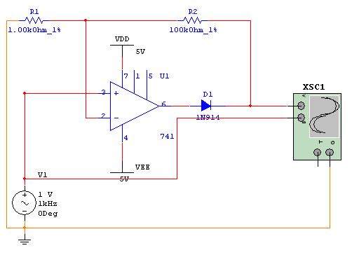

Try your opamp again without the extra resistors. The output resistor is not needed since the opamp output is push-pull, and the high current in the resistor overloads the opamp and causes heating which changes its input offset voltage. Use a single opamp since the other one in the dual might be causing heating.
