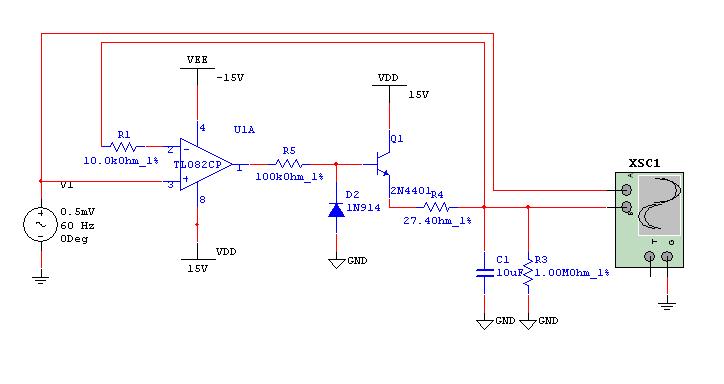

Try your opamp again without the extra resistors. The output resistor is not needed since the opamp output is push-pull, and the high current in the resistor overloads the opamp and causes heating which changes its input offset voltage. Use a single opamp since the other one in the dual might be causing heating.

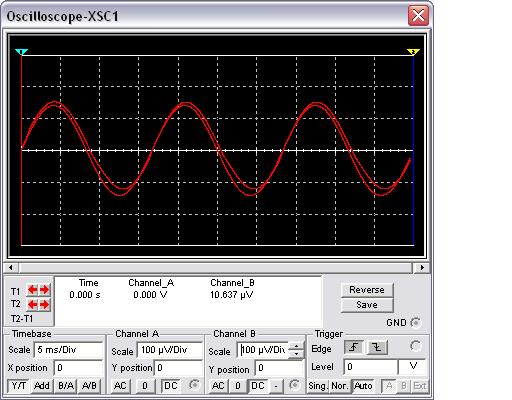

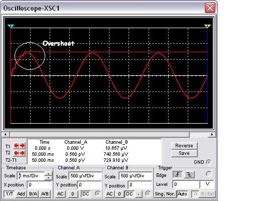

I'd removed the resistors and i'd increase the gain by increasing the R5 to 100k. This seems to give smoother output (it work like a half wave rectifier without increasing the R5).
Somehow, there is an overshoot at the very first waveform which is very important (only have to considerate the first wave as thats when the axle passed). I'm trying to make adjustment now. Hoping to get the result without overshoot.;)
R5 doesn't change the gain. The transistor is an emitter-follower with a gain of 1.
100k is too high to provide enough base current to the transistor for it to supply a high current to the capacitor to charge it quickly. Use 1k for R5 then try 1uF and 0.1uF for the capacitor to see if the overshoot gets less or gets more.
The circuit is a half-wave rectifier. A full-wave rectifier won't work in your peak detector application.
If i changed the R5 into a lower value, the output will oscillates even more. But if i change it to higher value again, the output will show more even output (althought been reducing gradually over the time).
From my observation, R5 should be higher while C1 and R3 (before output) should be greater when input signal is smaller.
If not, the output is as attached.
Null = changed to lower values.
Null1 = I think the best design???:eek:
I think offset of about 0.02mV could be ignored???

Simply that the peak detector output is supposed to rapidly increase to the peak voltage from the sensor, you then read that value, and to reset the circuit you need to discharge the capacitor - you could use an output from the PIC to do that - once it's taken the reading, reset the peak detector.
