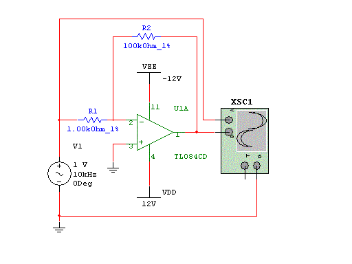

I'll try to do with it. Hopefully it works. I'd attached the circuit i done using the TL084. I wonder why it didnt work. I checked the pin already and the connection seems alright (for me :D ).
Got class now! Catch ya later~! Thanks!
Oh.. i missed out.. The signal is not amplified.. Input=Output!
Sure it is amplified. The inverting opamp circuit has a gain of 100 as determined by the ratio of the resistors. But its input signal is way too big at 1V, so its output is trying to go to 100V which it can't.
The inverting circuit has an input resistance of only 1k ohms which loads-down the output of the sensor. So make a non-inverting amplifier that will have a very high input resistance.

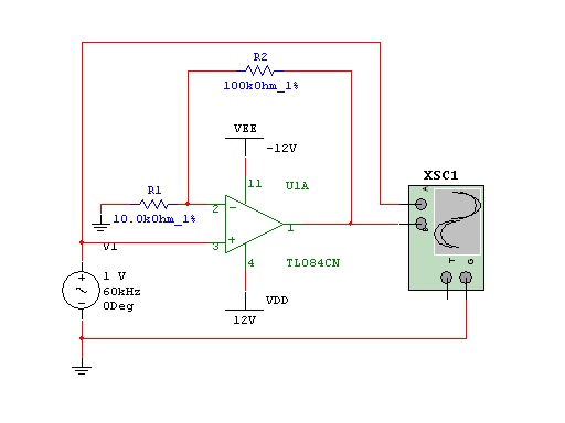

I'm sorry audioguru.. i tried increasing value of the resistance you'd told me. I even tried using others TL084 model and changing values. Somehow i could not get the result yet. From the image i attached, the output is zero instead! I wonder where i had done wrong now. Feeling hopeless with even a simple amplifying circuit.. Sigh...
Instead, if i use the amplifier TL082CP only i could be able to get desired result from the simulation.. maybe software problem in the component?
Your simulation software is stupid. The opamp should have a big output if the DC output of the generator is 0V and is 1V AC at 60kHz like is shown.
