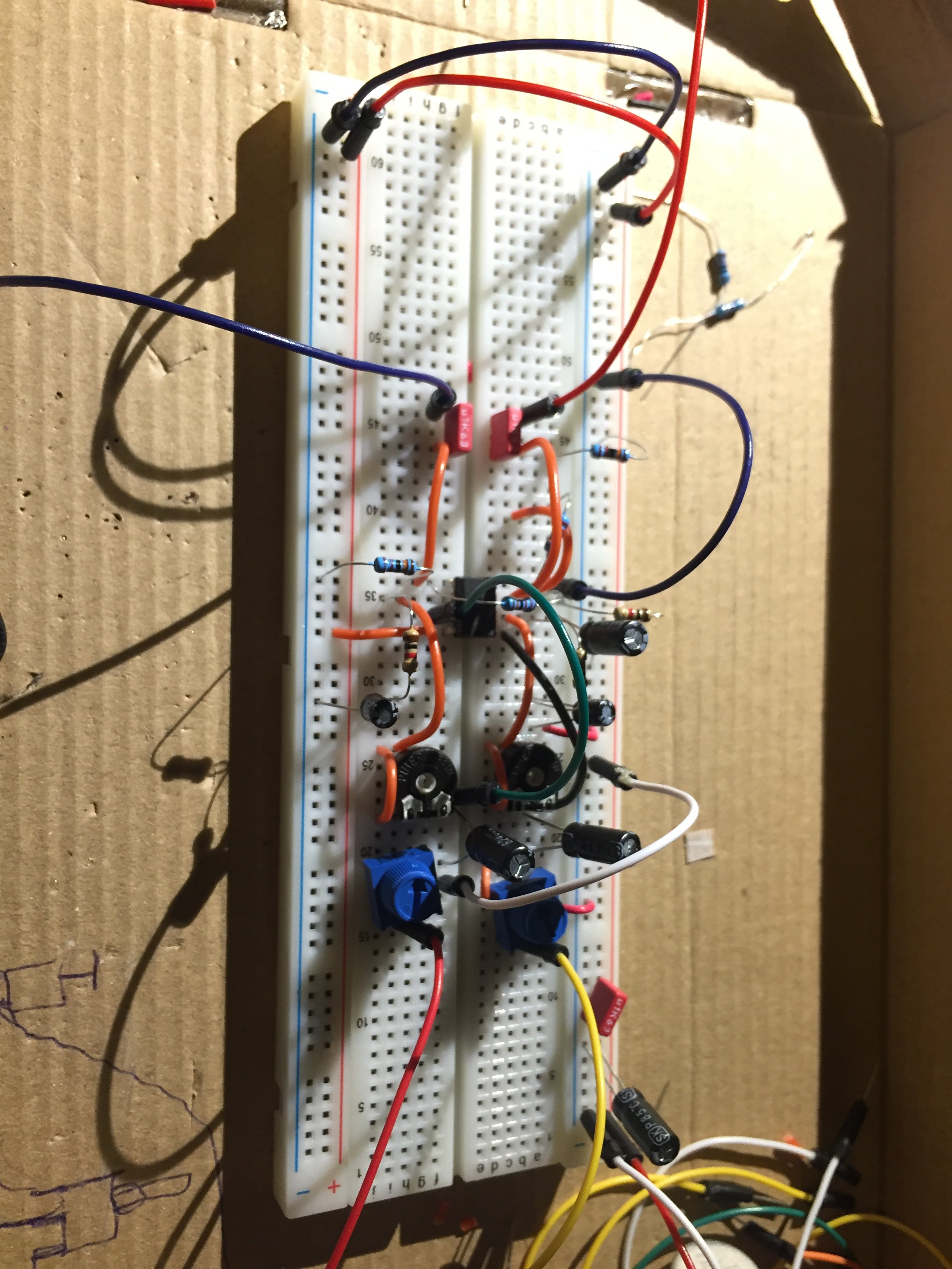

Wired it up but nothing happens just a huuummm :) anything I can measure to se whats wrong?

Oh dear. I hope the opamps are not oscillating. C1 (100nF) should be mounted as close as possible to the supply pins on the chip, with as short leads as possible, to provide good supply line decoupling. One dodge is to place the decoupling capacitor across the top of the chip and solder the leads to the top of the chip pins.
What supply voltage are you using?
Turn the 100K potentiometers to minimum (voltage gain of 1)
Measure the supply voltage and 0V actually on the pins of the chip
Measure the voltage at the junction of two pairs of 220K resistors: should be half the supply voltage.
All inputs and outputs of the opamps should at the same voltage as the respective junctions of the 220K resistors.
Good luck

(PS hate to say this but the breadboard layout may be a problem)

I get a amplified sound on the lower channel of the circuit.
gain pot does not do much but level do
supply voltage 12v
pin1: 10.8v
pin2: 10.8v
pin3: 11.9v
pin4: 0
pin5: 5.9v
pin6: 5.9v
pin7: 5.9v
pin8: 12v

Pins 1, 2 & 3 are incorrect. looks like there is a problem with the voltage at the junction of the two 220K resistors...wrong value?

Happy to know where the problem is :) Explains why only one channel is working. Resistor values are correct. I probably connected the resistors wrong.
Need some sleep and will give it a second try tomorrow. And practice a bit more on breadboard layout :D

The messy wires and rows of contacts on a solderless breadboard are antennas that pickup mains hum that is all around you. The contacts might be intermittent.
I found the problem at first sight today :). Had the both pins of a 220k resistor connected to IC pin3. Now I get sound on both channels. No hum at all, (2.2uF removed some little hum) Moved that 100nF closer to pin 8.
But... How impressed should I be? Gain control does barely do nothing. Level control can adjust sound to zero and to max. Everything at max gives not very much amplification. Almost the same as the first circuit "inverted" I posted.
Why is gain doing almost nothing, maybe I connected something else wrong?

The amplifiers should produce a voltage gain of x 1 (with gain potentiometer set to zero Ohms) and x 100 (with gain set potentiometer set to 100K) I suspect the gain set potentiometers (PR1) are 1K instead of 100K or the 1K fixed resistors (R3) are 100K.

Measured pots are 100K and resistors are 1K. So values are correct. Wierd... any other ideas?

Are the lower ends of the 1K resistors connected to 0V via the 4.7uF capacitors?
Are the 4.7uF capacitors the correct value?
Are the 4.7uf capacitors the correct way around?
What is the voltage on the positive connection of the 4.7uF capacitors (should be around 5.9V)?
22uF, or higher, capacitors in place of the 4.7uF capacitors would be more suitable: lower frequency response (but not connected with the fault)

Yes to all.
Voltage on 4.7uF is 6.5v, changed to 33uF but no luck. (Maybe sound quality got better with te 33uF. but not sure about that one) :)
When i use the 100K trim pot. Nothing happens to volume. Tone of the sound only changes slightly...
It is like it is bending the tone in some frequencies on the gain pot
pin1: 5.2v

Voltage on 4.7uF is 6.5v This is wrong- should be the same as pin 1 & 2 or pin 5 & 6

What meter are you using. Is it a digital multimeter. Can you establish what the input resistance is from the manual: sshould be around 10M Ohms.
It looks as though the opamps are oscillating, but not sure.

When disconnecting the siren that shares the same power source I get.
pin1: 6.06v
pin2: 6.06v
pin3: 5.99v
pin4: 0
pin5:5.98v
pin6: 6.06v
pin7: 6.06v
pin8: 12v
Using a UNI-T 139C multimeter
Of course it is oscillating. It is built on a solderless breadboard.
