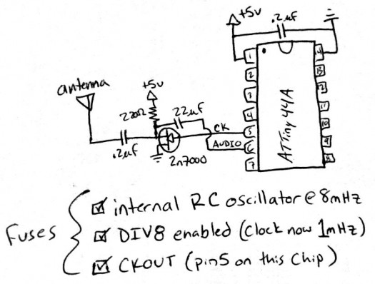

I got this working with the 12f675 at 1mhz , Then fed in a square wave , And i picked it up on my radio , I will generate the 457khz freq in software rather than use the clkout pin at 1 mhz , However i think i will need to amplify this signal as it is quite weak ,, I dont think the circuit is very efficient i will post a pic see what you think

...However i think i will need to amplify this signal as it is quite weak ,, I dont think the circuit is very efficient...
What are you using as the "antenna"? Likely, the circuit is efficient, but the antenna you are using is not...
Is there any reason that you can't use the microcontroller driving a MOSFET/BJT with a tuned ferrite tank circuit? This would be basically a class-C amp. with the resonant circuit described by MikeMl in post #7.
The antenna was a 300m/m length of wire ,, I will look into the tank circuit/Amp dougy , Ran out of time lastnight, I will do some more on this tonight

No i havent looked inside cause they are the ones cast in green epoxy resin with the coax plug for the battery , And doing so would wreck it ,, The thing i have got going at the moment is picked up by the mk1 receiver, on the bench have not tried it down a hole yet ,, I am going to drop the frequency a little but thats another pic micro learning curve for me ,,
