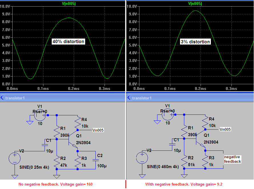

Willen;1079507I found a audio pre amp of BC547 (opereted at +6V) which has 2.2 Mega ohm base biasing resistor from positive and 270K base biasing resistor from ground. Why such large resistance? To get high gain? (Amp has 2.7K resistor at collector.)[/QUOTE said:
The AC gain of a transistor has nothing to do with the base biasing resistors.
With a 5.0V supply, a 2.2M resistor in series with a 270k resistor produces an unloaded voltage of only 0.55V which is too low to turn on a BC547 that needs a loaded base voltage of 0.6V.
Your transistor probably does not have an important emitter resistor to ground then it will not work properly.
Assuming that the collector is 3.0V then the collector current is 3V/2.7k= 1.1mA. The 270k resistor has about 0.6V but it changes with temperature changes. Then the current in the 270k resistor is 2.22uA. The 2.2M resistor has a voltage of 4.4V across it then its current is 2uA. So the base of the transistor has a bias current of only 0.22uA.
The DC current gain of a BC547 is from about 110 to 800.
If the current gain is only 110 then for a collector current of 1.1mA the base current must be 1.1mA/110= 10uA but your circuit does not have enough current so the transistor will be cutoff producing severe distortion most of the time.
You should learn how to bias a transistor. It is simple.
OK I am trying my best, and searching a perfect books suitable for me with detailed and clear discription but having difficult to find such books... Still searching. :)
You used a BC547 transistor that has a very wide range of DC current gain from 110 to 800. My simulation shows a BC547B that has a range of DC current gain from 200 to 450.
Your transistor is biased so it is almost cutoff because the base current is too low. It will be worse if the transistor has a DC current gain of only 110.
Your transistor has an AC voltage gain of about only 10 or less.
Your transistor will be cutoff if the transistor base-emitter voltage is a little high and/or if the transistor is cold.
My transistor is biased with enough base current and enough current in the voltage divider so that its collector voltage averages half the supply voltage so it can swing equally up and down.
My emitter resistor cancels most changes in base-emitter voltage and differing current gain.
My collector resistor is 10k (instead of 2.7k like yours) to stop wasting current.
My transistor has a voltage gain of 80.
An electret mic needs 0.5mA of current at about 3V so the resistor feeding it from 6V should be 3V/0.5mA= 6k (use 6.2k) not 15k.
The 10nF capacitor parallel to the mic cuts audio frequencies above 6khz. FM radios are supposed to play frequencies up to 15kHz.
The 103 (10nF) coupling capacitor value is too small and will cut low audio frequencies. I use 330nF.
The 1.5k resistor is not needed.
The values for your base bias resistors are much too high for any transistor unless the collector current is very low.

That is backwards. The voltage gain of a transistor is Rc/Re. Rc is the collector resistor in parallel with its load and Re is the unbypassed emitter resistor in series with the transistor's internal emitter resistance which is in a fortmula involving collector to emitter current.
So a high voltage gain is when the collector resistor value is high, the supply voltage is high (for a higher current) and the transistor is biased correctly.
But a transistor produces severe distortion when its voltage gain is high and its output level is fairly high.
Here is a simulation of the distortion which is heard and shows on an oscilloscope:
