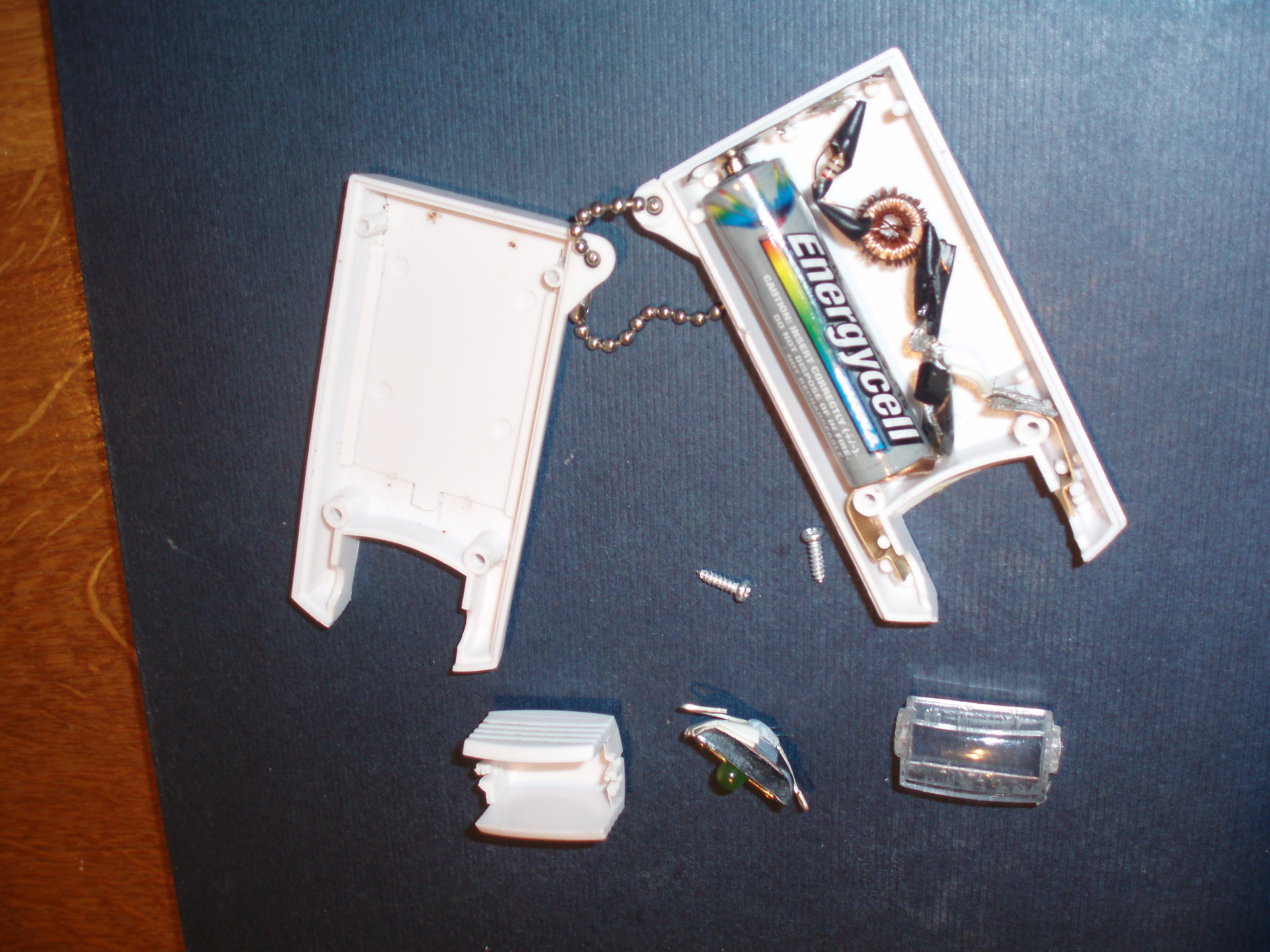

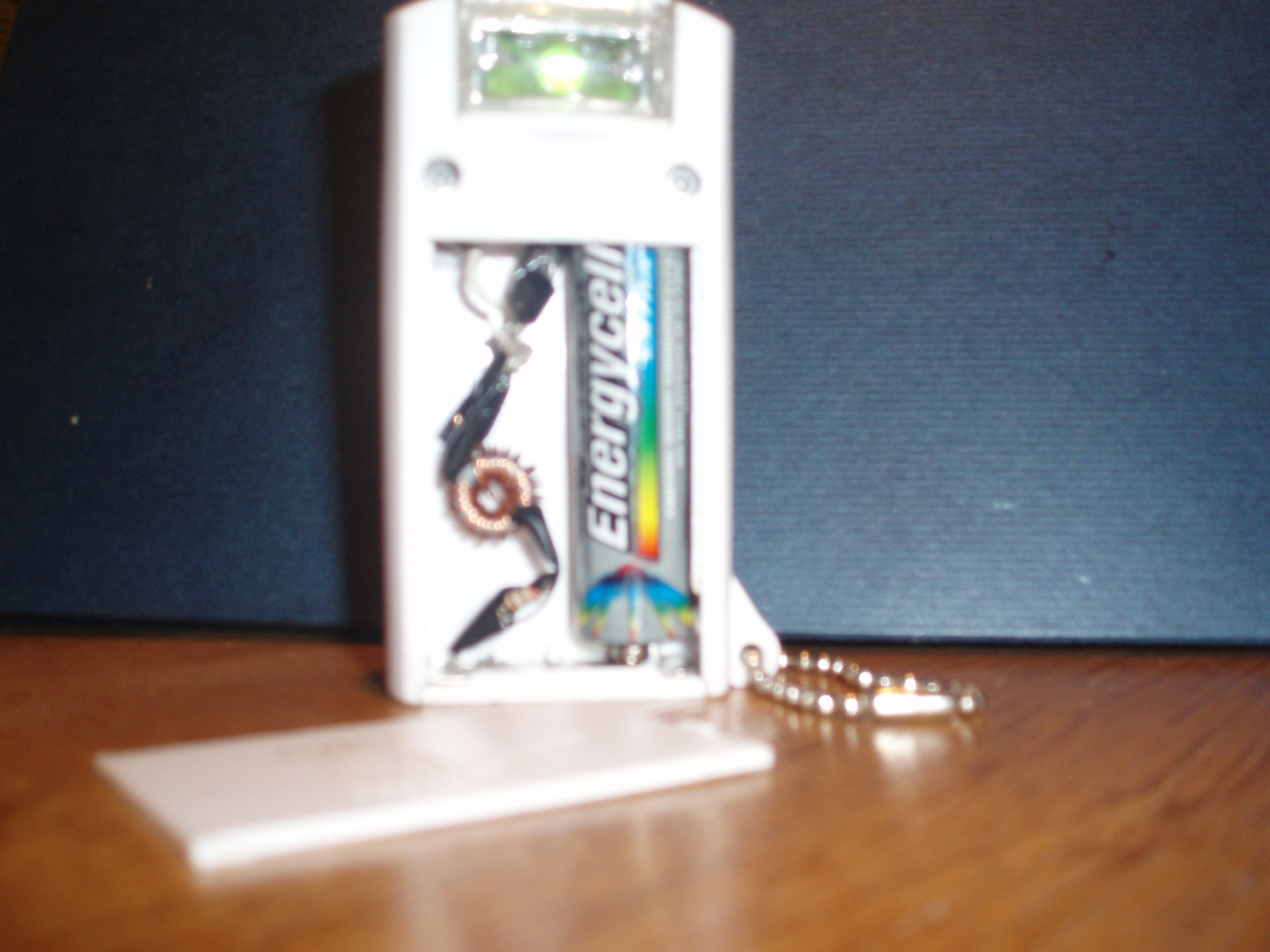

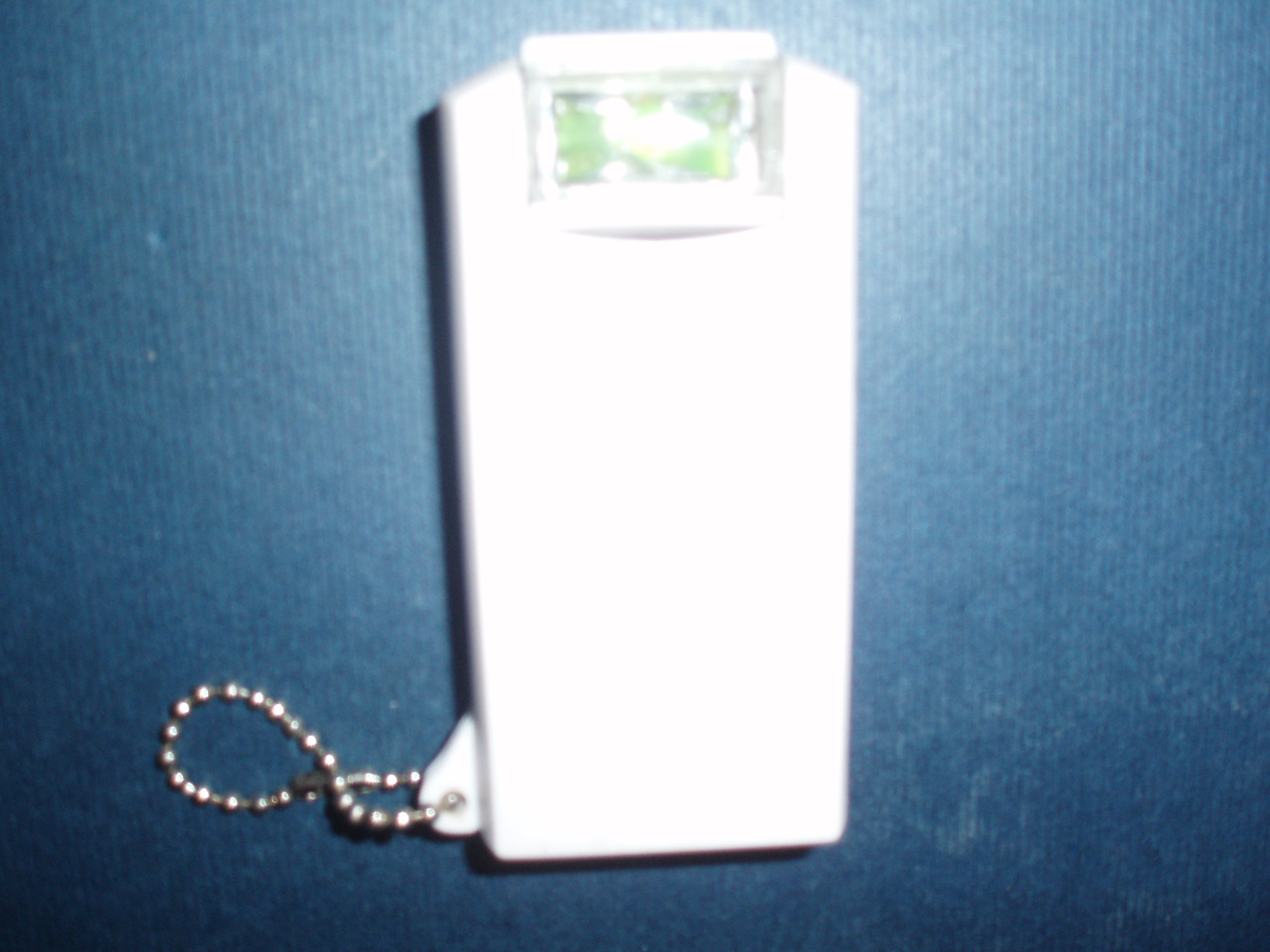

since i've seen yours, thought i'd show you mine :eek:
I've built a joule thief in one of those cheap torches they usually give away with stuff, where you swivel the bulb head to turn them on. The neat thing is that the LED sits in the head and is easilly replaced so you can swap colours easilly without having to mess about with soldering, and theres no switch, you just spin the head.
