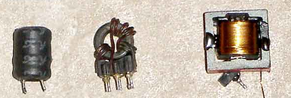

When you wrote "shielded" were you thinking about this style (above)?
I've used this style as the inductor in buck converters, not because they are shielded but because they were the cheapest chokes my distributor had with the value I wanted.
There are applications in which you don't want a transformer or choke to induce currents in other circuits, such as in audio amplifiers (I imagine that is why you find large toroids in audio equipment power supplies. audioguru can tell you more about this.
They should work the same as unshielded chokes in Joule Thief circuits.

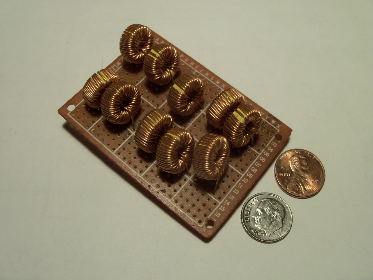

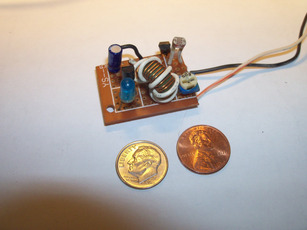

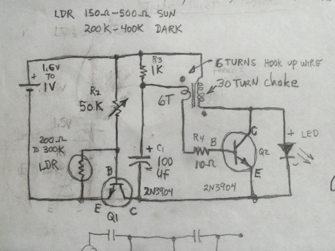

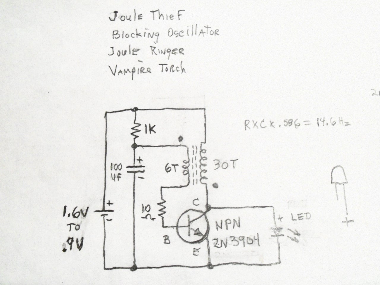

I bought a bargain pack of 30 turn choke coils to build a Joule Thief. 6 turns of wire makes it work perfect with a Blue color LED. Later I added the LDR circuit so it only comes ON when it gets dark outside. Notice DOTs on circuit drawing for polarity. Don't worry if you wire it wrong 1.6v will not smoke the LED or the transistor.
A Joule Thief is supposed to use high quality inductors so that it has high efficiency which uses a low battery current. A "bargain" choke with few turns of wire will probably be very inefficient which uses a very high battery current.
I bought a bargain pack of 30 turn choke coils to build a Joule Thief. 6 turns of wire makes it work perfect with a Blue color LED. Later I added the LDR circuit so it only comes ON when it gets dark outside. Notice DOTs on circuit drawing for polarity. Don't worry if you ware it wrong 1.6v will not smoke the LED.
Hi Gary,
What LDR did you use? I have some GM5539 but that is all I have. I never figured out the best way to choose those so I bought one in the middle range. Otherwise I was going to also mention that the toroid looks like a not so efficient design but I am sure it works just fine otherwise. The wire gauge looks too large for one. What AWG wire is that anyhow?Thanks for posting the circuit.

Look at the 2nd circuit drawing it shows LDR resistance. Someone in another thread mentioned if you have 30 LDRs they will all test different resistance will be all over the place and that is correct. R = 150 to 500 ohms in sunlight. R = 200K to 400K in the dark. R2 resistor is light sensitivity adjustment when sun is low & it is getting dark. No part numbers on my LDRs. Set R2 so LED does not come on until very dark cheapo dollar battery will last 6 months. NOTICE the date on dollar store batteries sometimes the new packages are dated 2 years old those OLD batteries are junk they go dead very quick. BLUE color LED is higher voltage than RED LED change the 6T coil 1 turn to lower voltage for RED LED.

Ok thanks for the added info Gary. I can figure the rest from there. I may have to buy some different LDR's or do some other tricks to make mine work. Good thing they are cheap. :cool: I too love Eneloop batteries and have a bunch of the rechargable AA sized 1.2V ones and a couple of chargers from Amazon.
