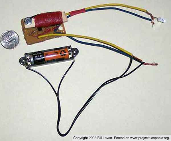

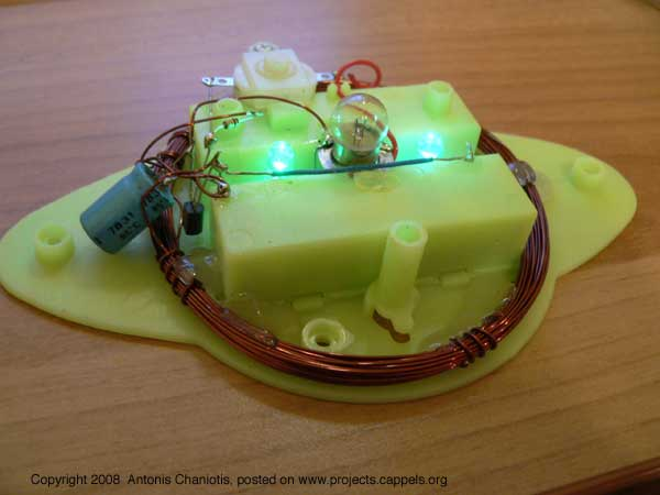

People often have a lot of worry about the core and make it harder than it really is for this non-critical circuit.
A nail does not make the best core for a switching power supply -that is why the 2700 pf cap is needed, but see how easy it can be?
This person wound his tapped inductor on a piece of wood!
This fellow wound his tapped coil around the lamp enclosure.
The above lights used a circuit that is electrically equivalent to the Joule Thief but does not use separate windings for base and collector circuits.
Thats briliant idea, no more buying of nanodust cores. I will use nail, becouse losses are not what i am aiming for =D.
