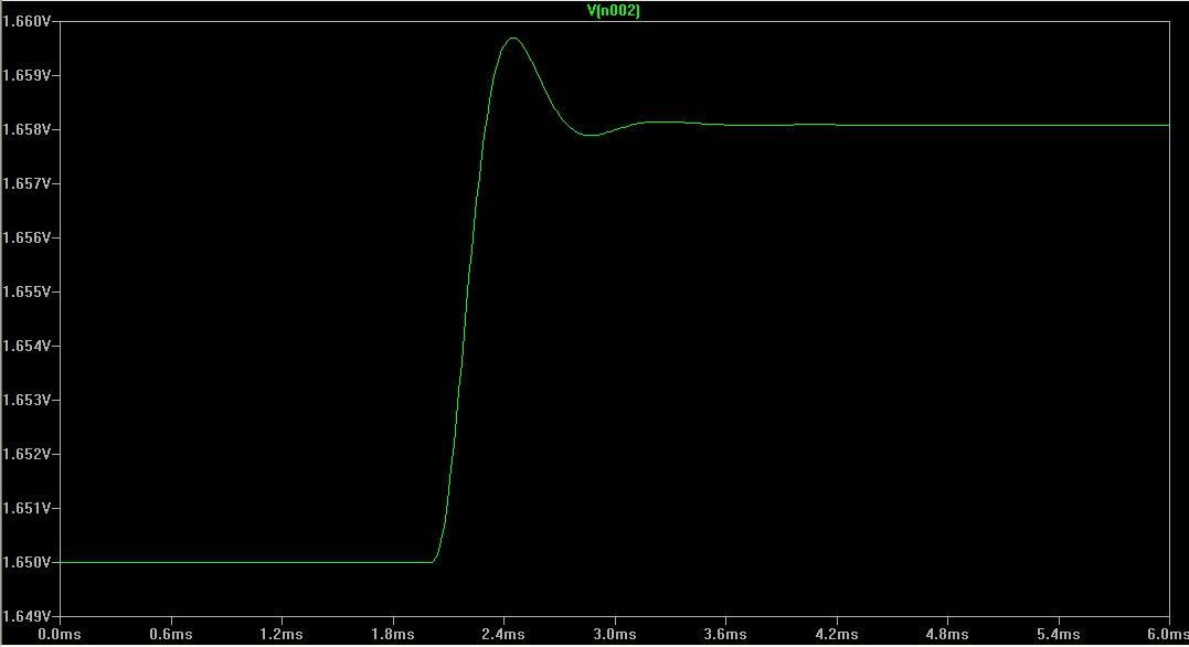

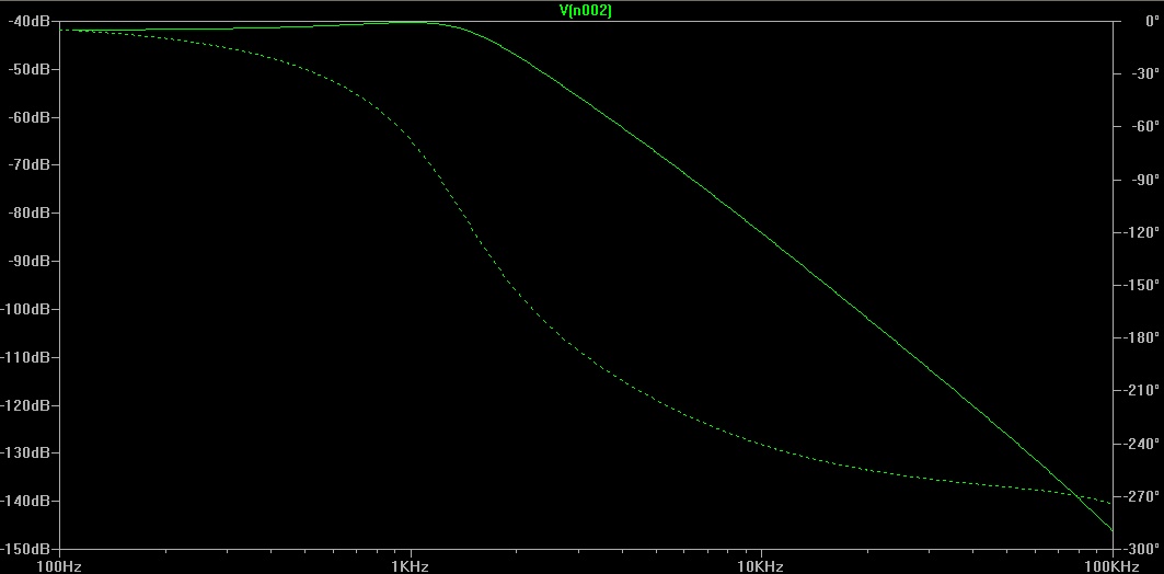

I might have done the same thing using spice.
See the two pictures.
The real circuit was close to the spice.

i have modelled it in multisim and have answeard my own question.
i can now see that the frequency response and step response should be the same.
I am happy with out data and our calulations.
It would appear that the weay we conducted the experiment may be causing the error.
I think we now just need to conclude as to why the error may exist.
