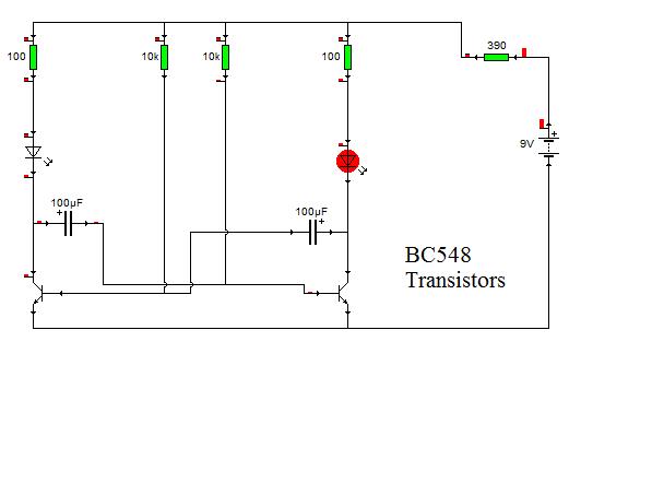

G'day all,
Am new to electronics and chasing some help. Have to make a astable multivibrator. We are powering it with one 9v battery, running through a protection diode. This then goes to four resistors, two 10k and two 390. The line following the 390's then goes into the LED's and after which is then cross coupled thorugh capacitors and into the transistors. What i am after is that i need to find a source (website) that tells me why these size resistors are used, and same for the capacitors and also the transistors.
I am using 100uF 16v capacitors, then removing these and fitting bigger ones up to 470uF and 16v. I know that as they get bigger the flash rate slows down, but need to find a reliable source that syas why to include with the circuit
thanks,
mitch

Your drawing looks wrong, but dougy has a good explanation for the 'correct' circuit.
There are a couple of things wrong with your circuit-the timing capacitors are reversed(they should be connected with the +side connected to the timing cap and resistor then the base of the switching transistor),and the 390R resistor isnt needed-increase the led series resistors to 470R-plus by adding a few extra parts as shown in my schematic the leds flash is a bit better .... instead of increasing the value of yr timing capacitors try increasing the value of the timing resistors which will also slow the circuit down.....do not be scared of it!!!!

His drawing looks fine to me. The capacitors are correctly orientated - the transistor base never goes above 0.7V, while the collector can approach the rail voltage. Maybe the 390R is not a usual addition, but I can't see it not working.
I don't think the 390 belongs in there. And, following his desctription, the collector resistors are supposed to be 390. Looks like he just got confused. If he made the collecotr resistors 390 and removed the extanious one, it would be fine.

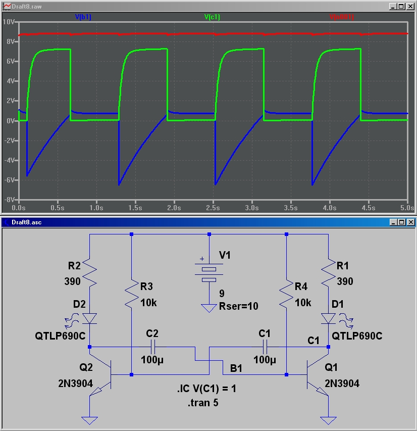

Looks ok to me. You dont need the 390 by the battery. The waveforms look better without it.
btw, this should answer the question about using polarized capacitors.

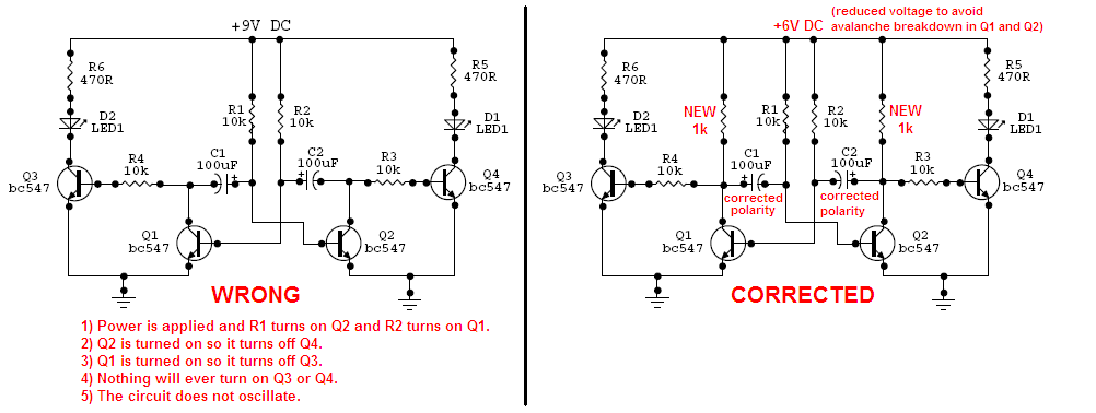

for one the circuit ive posted does work and it works very well the two extra transistors added ensure the leds when they switch on and off do so quite rapidly if u connect them as his first drawing shows the leds seem not to switch as cleanly as they do when you add an extra transistor....the electrolytics in my schematic are the wrong way round...plus it seems i missed a couple of resistors out ..i think i need glasses!!!...if you are in any doubt as to wether the circuit iv posted will work ill build you one and post it to you.......as per my schematic.......dont be scared of it!!!

I say "build it" and post it. I don't think it will work either. Transistors Q1 and Q2 will keep the others cut off. I just think there's a mistake in the drawing.
glasses are now on order-corrected version is here that does work as per the schematic ive uploaded-do not whatever you do be scared of it!!!...........

Sheldon,
Your circuit is wrong. I corrected it but it does not need 4 transistors and will work fine with only 2 transistors.

Please explain in words how this is supposed to work????
I'm not familiar with that particular transistor, but it they have a forward gain of more than 2, then q1 and q1 will be saturated, even so for guru's circuit, if the gain is more than 10.
