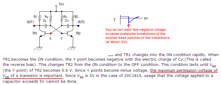

The Japanese guy also talks about the transistors breaking down if the power supply voltage for the Astable Multivibrator is more than 5V or 6V.
The max allowed reverse voltage for the emitter-base junction of a silicon transistor is 5V to 7V. The base of each transistor in an astable multivibrator is driven negative.
Diodes can be added in series with each emitter to stop avalanche breakdown.

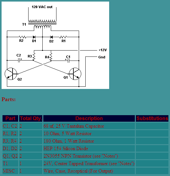

There is a 12VDC to 120VAC inverter project that uses an Astable Multivibrator. It doesn't work because its capacitors have backwards polarity and the transistors have avalanche breakdown which causes the capacitors to explode even if their polarity is corrected. The inverter schematic is here:
