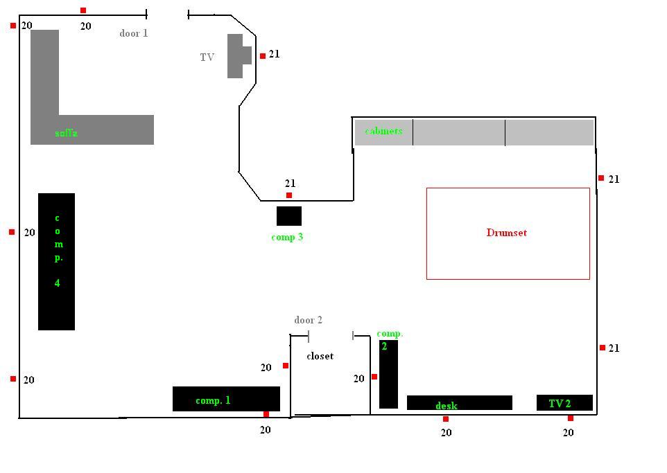

i tested the outlets and they are fine, ill plug the 3 prong cords into one circuit and everything else into the other circuit
ok I have an overhead swaring of the basement and the outlet positions as well as their breaker#
ill bring that up and list whats on each circuit.
I have to get some bigger surge protectors...i have one plugged into another because these wall transformer type units are big.
OK got that list done.....we have a bunch of things plugged in down here.
ill attach the files.
file one is the photo layout of the basement...outlets area the red boxes and the 20 and 21 are the breaker #s which are both installed in the main circuit panel (not the sub panel)
file two is the list of whats plugged into what circuit.
there's a bunch of outlets on circuit 20 but circuit 21 can have 3 added to it and ill probably end up doing that so i don't have extension cords running all over the place.
