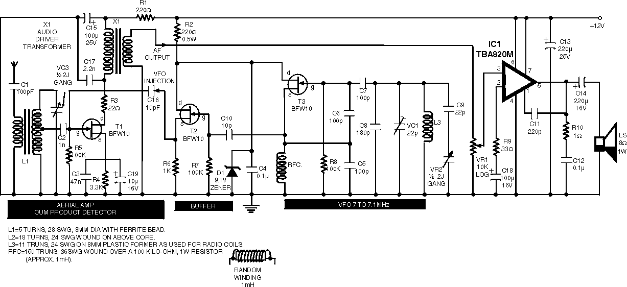

I'm also going to try a 40m SSB. Circuit is here :)
A much advanced circuit :p

My video player does not show clipping of the audio. The severe distortion might be caused by the many high gain transistor stages that do not have any negative feedback and each has 40% or more distortion.
My video player shows an extremely narrow audio bandwidth which makes the guys sound like female ducks. I don't hear any hum so why cutoff all the low frequencies?

Well much better designed anyway :D
Notice in particular R1 and R2 and associated components for decoupling and regulation, and the absence of lots of un-needed distortion stages.
However, while it will certainly outperform the circuit in question, a proper superhet is really the way to go - but a direct conversion receiver like this can certainly perform.
