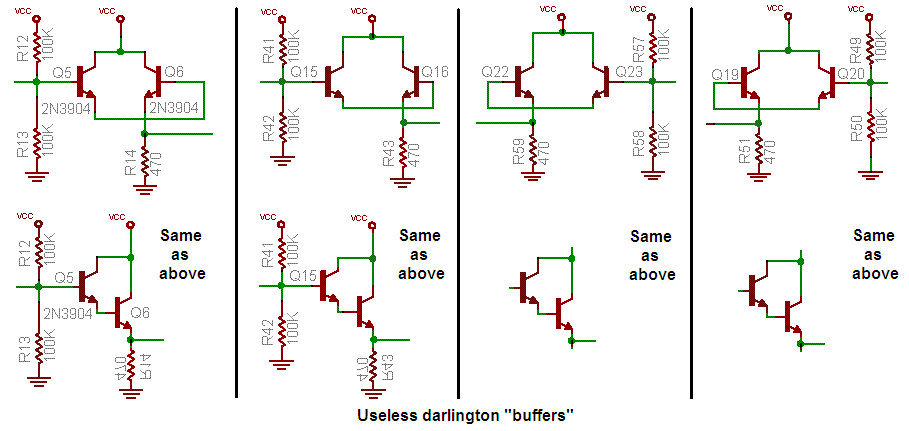

Don't like my design Nigel? You don't have to buddy. I works! It works damn good!!! When you say it has too many stages and they are a waste, that's where your designs are crap on mine are superb. I'm a firm believer in buffering. It comes from experience Nigel. Build a couple of receivers and find out. ;)

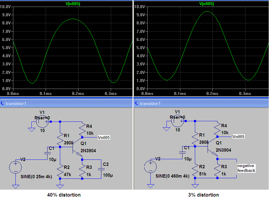

Your audio amplifier has many stages with a lot of gain. Then many attenuators. You end up with reduced bandwidth and distortion.:(
Your circuit has many transistors at max gain without any negative feedback. You should have used negative feedback to reduce the distortion. Attenuators do not reduce the distortion.
My simulation shows a high voltage gain and 40% distortion.
The second half of my sim has much less distortion due to negative feedback but the gain is reduced.

Your stages aren't buffering, they are simply a waste and performing really badly - I don't think any single stage is designed anywhere near correctly?.
I'm not trying to build a radio, I did all that decades ago - but never built one as poor as this.

Your four buffers look like differential amplifiers but they are actually just useless darlingtons that are not needed.
A darlington has a very high input impedance that is not needed.
A darlington has a very low output impedance that is not needed.
A darlington has no voltage gain.
Well...let's see some of your old crappy designs from decades ago.
What do got? A couple of 6L6's in some sort of direct conversion garbage?

Ah....that's where you are wrong. They are deliberately Darlington amps. What do you think a Darlinton is? I'll tell you. It's a BUFFER.
Yes they have high input impedance and low output impedance.
Precisely what I was after.
Bottom line is performance. If you can add low power with performance than I would say that is the trend.
