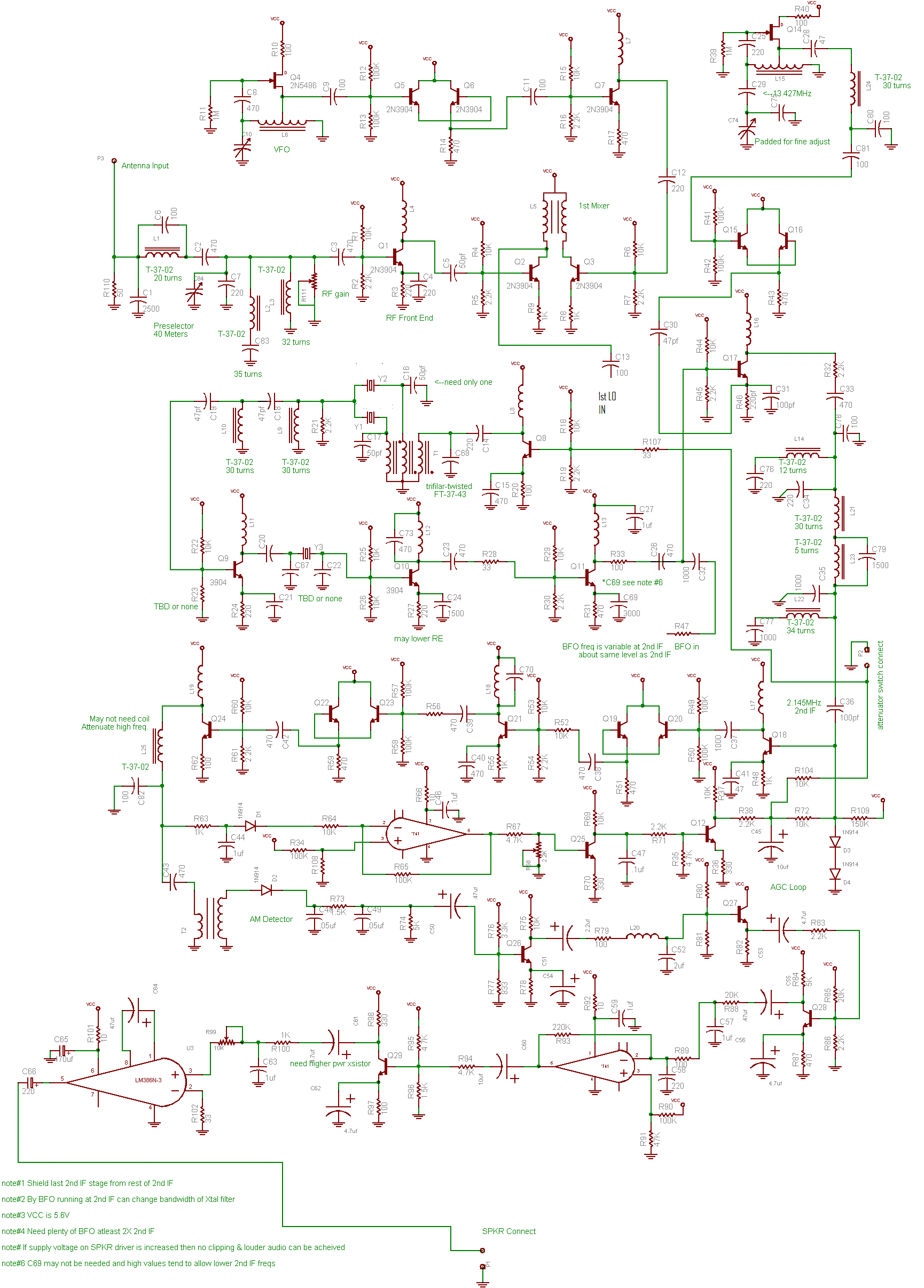

Thanks Uncle Scroogie. I got it licked. I have seen the crim-da-la-crim of receivers and I am happy with my formula. Very happy. It does everything. I did change that chip driver the TDA2822. I pulled the voltage amp and took two 2N2222As and made a Darlington current amplifier. .......Beautiful! That was the ticket. I went back through the whole audio and ballanced the frequencies and gain distribution to where it will receive a monster signal intelligently in AM down to the weakest SSB signals.

I put in a couple of nice features like a 1st IF gain control & a 2nd IF gain control. The second IF gain control uses a variable capacitor for minimal skewing of the IF envelope. It was a very convenient place to add the BFO. I the BFO perfectly ballanced and loaded for minimal drift. I can adjust upper and lower sideband.

One thing that is really slick that I just lucked out on is the LED signal strength indicator. As I change band select filters and proceed across the dial there will be varying levels of IF. It's relatively flat but there are a few humps that will contribute to birdies. You do not hear any birdies because the signal strength is much greater.
At any rate, what's nice is I can use the LED to to reduce the IFs to where the LED is barely ON. Then it not only is a good indicator of when there is a station, even it is so weak I don't hear it at first. Better than that, by not driving the IFs to excess, being the more amplification the more transistor noise that is generated, I can keep a very clean level giving me maximum S/N.
My schematic is still somewhat on paper but this is the first iteration that does work quite well. As I get it detailed I will post.
As you can see the audio is still not up to date.
Also I purposely erased the Crystal frequencies. That's my little secret to allow me to buy cheap off the shelf crystals to build my filters with. I'm not using standard IF freqs for two reasons. One is so that I will not be easily jammed and secondly the 2nd IF is adjustable LC filter instead of fixed ceramic as is usually done. I still have a reasonably high Q well suited for communication work.
Made a mistake. Where it says "1st LO in"...that is incorrect. That is the mixer output. It goes over to the attenuator switch which comes back to the IF amps just below.

The circuit is far too full of design errors to comment on, but an obvious one is the almost complete lack of any supply decoupling - a couple on the 741's, but NOT on their virtual spilt supply, and one feeding the output IC with a 10 ohm series resistor - the ONLY place you didn't need one, and 10 ohms will cripple the output.
c50 might be backwords.
r68 is wired funny.
bypass the top of r108
make r760 two resistors and bypass the one connected to vcc
etc.

With all respect, why are you using a general purpose switch transistor like the 3904 for your front end. This stage sets the IP3 and Noise figure for your whole rcvr?
The datasheet for the 2N3904 does not even spec NF above 100KHz, so I imagine it is not very good. The IP3 for that part is not very good either so your first stage will produce many Intermodulation products.
I would change that part to a more suitable device. I can look one up for you if you wish.
I think intermod is more a function of the mixer. But I am using 3904s for my first mixer.

But there is something to be said for intercept points in regard to intermod and that is strickly a function of the mixer. I think diode ring mixer are very good in reguards to that particular characteristic due to the fact that they are lossy. But then, what are you loosing and can it be made back up in the front end.
I prefer the preselector approach. I have not detailed mine out yet.
Your sadly mistaken. IP3 is a function of distortion and it is of concern at many stages of a radio. IP3 products in the first stage means unwanted in-band products that are not easily filtered. Clearly, if your first stage amp produces unwanted in-band products then it will most likely pass though your mixer, and your rcvr will not be able to filter them out, and you will end up with a very noisy output. That is all I have to say about it. If you are too stubborn to recognize when someone is trying to assist you, then you are welcome to all the problems you encounter.
Your so busy trying to defend, that you are not able to recognize sound advice that may help improve your project. At this point, I put up the arm waving surrender sign.
