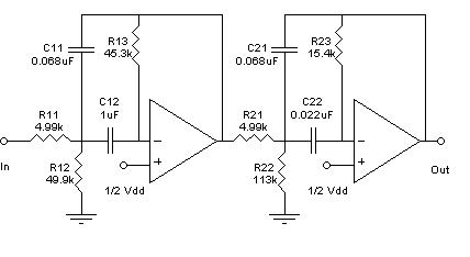

how about this bandpass filter? its supposed to allow 60Hz-340Hz. I was playing around with FilterLab. I am not too experienced with multi-stage filters but i think this is a butterworth filter. The only problem is i can not rebuild the circuit, cause i forgot the attenuation values i used. Nonetheless, i think it should work fine with x10-x20 gain preamp.
Ohh and i noticed that i have to be very precise with R values when building multi-stage filters. Correct observation?
Do you think this filter will solve my problem?

I'm planning to wrap all my audio carriers with aluminum wire mesh (mosquito screens - i dunno if thats what its called but you kno what i mean). That should help?
NOTE:
I'm using TL084 for opamps and LM386 for preamp.
