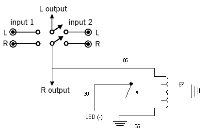

I have a piggy back question to this, I am considering wiring in an LED to each side to show which side is on, I know it's a bit redundant.
My question is, if I use two spst relays (one for each output) and use each output to trigger them, will this cause any type of interference?
Here's a quick schematic.
Would it be better to switch the + or - ?
Thanks again for the help!
Problem is you have the relay coil connected to your signal, which ain't gonna work.
For this, you would need a 3PDT switch (2 poles to switch L&R channels, one pole to switch LED power).
Well, unless you placed DC power on both inputs (enough to energize the relay), and used decoupling capacitors on both outputs and the input to block the DC. This would work, theoretically. However, you'd probably get quite a nasty thump! out of your sound system every time you switched input sources.

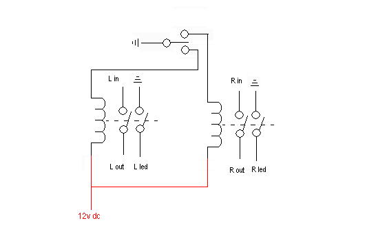

I wasn't sure if the nominal voltage would activate the relay, I must have had a brain fart, I forgot you need full voltage to activate it.
Would it be worth trying to use a SPST switch and a a seperate DPST relay for each channel and led?
My fear here, is that I am running my audio so close to an energized coil, which might cause some interference.
For the extra $3 it'll cost to order the parts, I may try this to test it out.
Thanks again for the input!

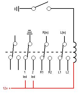

If you want to post a schematic of your final circuit, we can critique it before you build it.
Diagram
Here is the diagram. I plan on using a simple SPST switch with a NC 4PDT relay. I think I've notated the diagram well enough to show what goes where. I am switching the ground on both the coil and the led. Is this the best way to switch, I think I remembered this correctly.

Looks ok otherwise but you need a current limit resistor in series with each LED unless they are designed to work from 12V (which would mean they have the resistor built in). Otherwise you will have a one-shot LED putting out a nice, short, bright flash.
Just a small note for your benefit: since the relay is xPDT, it's neither NO (normally-open) nor NC (normally-closed). Double-pole switches have one NC side and one NO side. Single-pole switches, on the other hand (xPST) are either NC or NO.
But yes, I agree with Carl that it looks OK (be sure to use LED resistors).

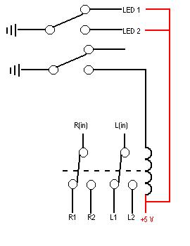

They are 12vdc LEDs with the resistor built in. But thanks for the heads up. The more I think about using 12v and where I will tap in, the more I am considering using 5 volts and using a usb source for power. This will be in my center console where I currently have a dual usb charger, I think it would be a lot more useful (and versatile) if I could simply plug the power source in, instead of wiring direct, as I intentionally planned. On that note, I have found a suitable dpdt switch, so I may use it with a dpdt relay. With the switch operating the relay and leds, and the relay operating the L&R channels. The relay is MUCH smaller than the 4PDT 12v I was going to use. Since I am using a small case, I think this would make things easier.
Here is what I was thinking.... any thoughts? Any reason one would be better than the other?

I like this arrangement the best so far. Smaller relay, as you pointed out, and somewhat simplified wiring.
I see you're using the "automotive convention" here, where you're switching things to ground rather than switching V+. Nothing wrong with that, it just caught my eye.
Yeah, it will be used in auto use, and most wiring I have done has been for various auto projects. Is there truly any advantage either way? Just curious.
This arrangment will also be easier and less complicated physically because I will have the leds on either side of the switch, so I can simply connect them straight to the switch w/o running wires to the relay, keeping them further from the audio wires.

Here's a tiny little refinement to your circuit: arrange it so that the relay is energized only when you select the lesser-used input source. (In other words, route the most-used source through the NC set of contacts.) That will keep the relay off most of the time and extend its life (and lower power consumption).
