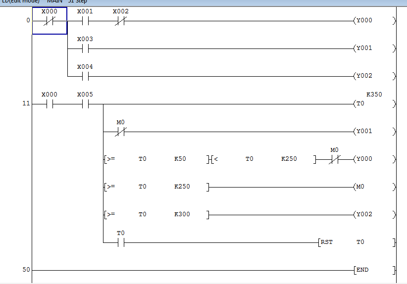

I have written the ladder logic for a Auto Manual switch for a competence test. The problem im having is the Y000, Y001, Y002 output seem to cancel each other out in Auto from Manual.
Can some one have a look for me?
Regards James
