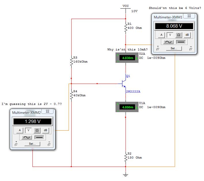

As you can see from the attachment I have plugged in the values, but as you can see the meter readings arent immediately what I expected.
For instance I was expecting to see 6V and 10mA at the collector. Also a PD of 2V at the potential divider junction feeding the base.
I have been thinking this through and I just wanted confirmation.
1. The reason the base voltage is registering 1.298v is because it has dropped 0.7v through the "be" junction of the transistor?
2. Because the simulation has done this, the Collector Voltage has dropped to 8.068v. The only way I can explain this is by Vcc - (Rc x 4.83mA) = 8.068?
Do you agree with this?
I can't explain Ic though?

The problem is that you've calculated the values for the potential divider wrong. As a rule of thumb the thevenin resistance of the divider should be at less than: Beta * RE * 0.1 (200 * 130 * 0.1 = 2.6K) for a "firm" divider. In other words, if your base current is going to be 50uA then you should have at least 10 times that flowing in the divider.
To add to what kchriste has explained, if you want 10 mA to flow in the emitter, and if the gain of the transistor is 200, then you need about 50 uA to flow into the base. This 50 uA has to flow through the 160Kohm resistor in addition to the voltage divider current. The trouble is that 50uA will cause a huge voltage drop in the voltage divider because 160K is just way too high. You want the voltage divider current to be much more than the base bias current so that the base bias current doesn't change the base voltage very much.

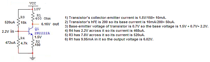

You are very close, if the hFE of the transistor is 200, not 100 and not 300.
UTMonkey said:
Thanks AudioGuru, what do you mean by (200, not 100 and not 300)?
The hFE (current gain) of the 2N2222 is from 100 to 300, but is typically 200.
You calculated only when the hFE is 200.
Calculate what happens when the hFE is 100 and when it is 300.
Just looking at this now, one question though. looking at your diagram you notes currents 520uA,472uA and voltages 6.16v, 2.2v.
How did you come by these?

I just used Ohm's Law. My numbers this time are slightly different.
