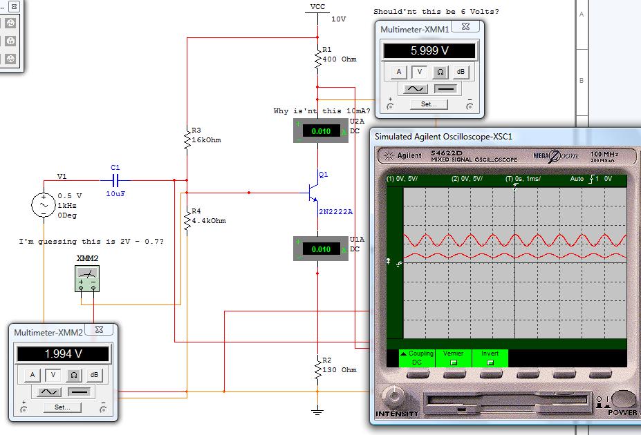

I also took the values from the "new" 200 gain calculations, coupled the input with 10uF cap and put a 500mV AC signal through it.
Look at the screen shot of the results.
Any comments?
Your transistor works. Its input DC voltage is very close to 2V. Its output DC voltage is very close to 6V. Its current is 0.01A which is 10mA.
Its input signal is 500mV and its output signal is 1539mV so its voltage gain is slightly more than 3.

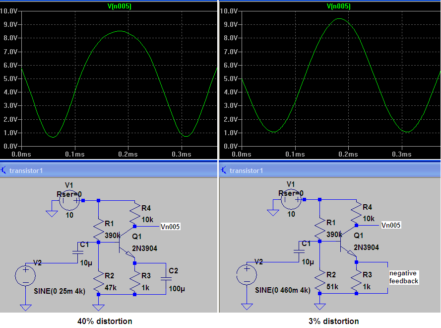

You don't want a transistor amplifier to have its maximum amount of gain because its distortion at high levels is horrible like this:
