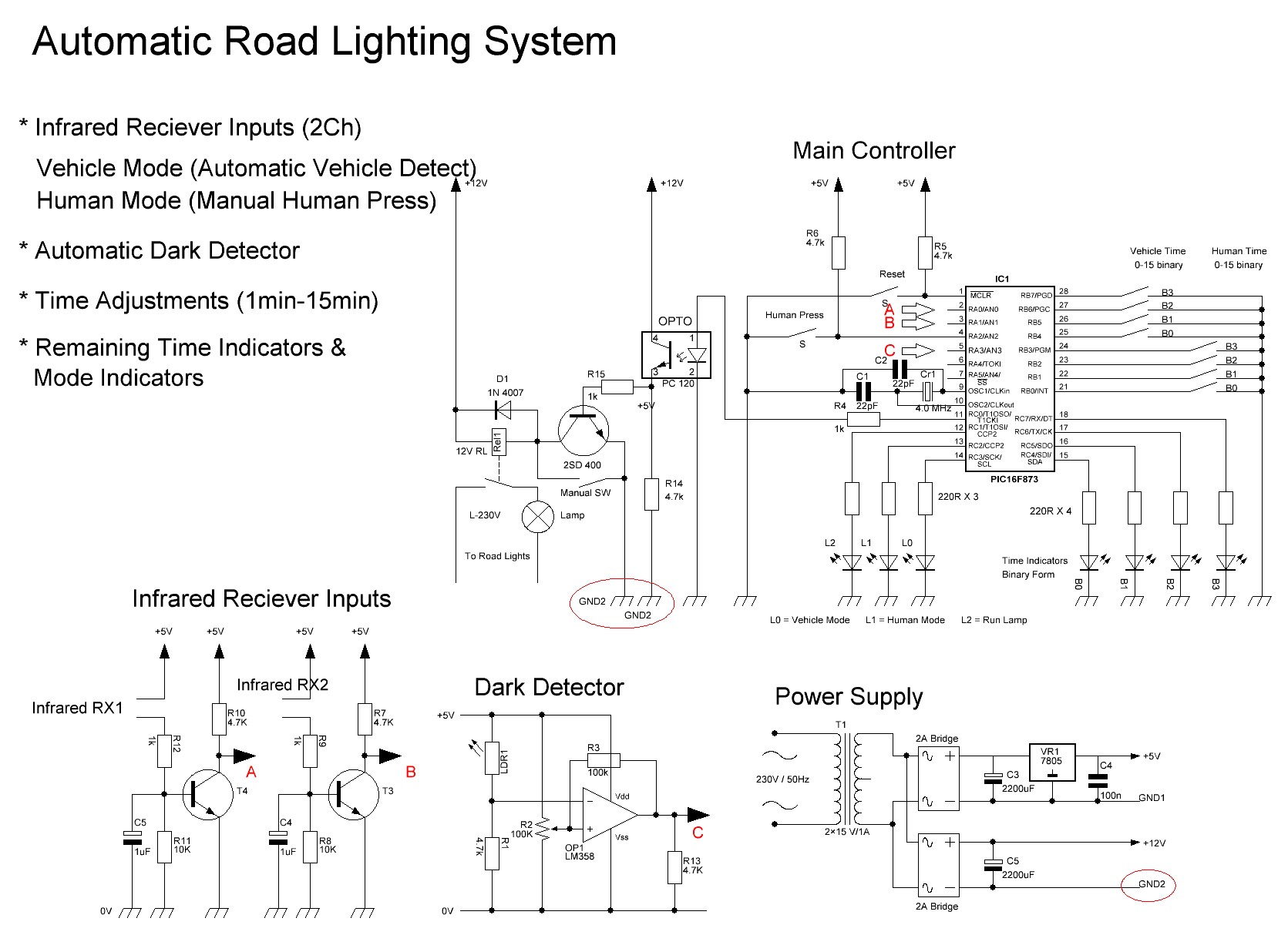

Similar thing did recently don't know whether it is relevant.Do not think it too much.
Goodness knows why you'd want to use a separate comparator when your're using an MCU or another bridge rectifier or the 12V supply, when you could just tap the supply before the one used to power the LM7805.
:D
This is an industry project not a breadboard project :D.The load is too heavy though it is resistive loads & don't know what bulbs customer uses in later time.I used to isolate the relay thing from the MCU side.
LDR is placing a bit length from the circuit also the AD is varying speeder in different light conditions.It also needs a dark level adjustments.
By using a comparator I'm free of doing AD sampling, comparing , adding hysteresis etc.......

gayan I would like your help which part of the the overall project should i consider tackling first. i also took a look at your schematic, what exactly does this system do. it is a system that turn lights on when a vehicle enters a garage or something to that effect or is it something entirely different. i would also like to know if badscrs method like what he spoke about with the plc is also possible with your system instead of using a dark detector. i figure if it is used there would be no need for a dark detector circuit.
essentially what i am asking is what is the best way to approach and what should i consider doing first.
That little circuit do this!
Let say you have a 300m road from the gate to house.Gate side has 2 IR sensor pairs.Also house side has 2 IR sensor pairs.Also you have two controller circuits on both sides (my cct).There is no any connection between those two controllers.Only lamps 230V line is common output to both of the controllers.
Gate side IR sensor pairs do this.
When a vehicle comes from outside the gate to house side then the street lights must turn on a particular time.But when a vehicle comes from house side to gate side it won't turn on the street lights.
House side IR sensor pairs do this.
When a vehicle comes from house side to gate side then the street lights must turn on a particular time.But when a vehicle comes from gate side to house side it won't turn on the street lights.
That is the basic of this system.But there are hidden logic feeded to the micro controller to do so many tasks.
For humans there is a manual switch to turn on the street lights.It will auto off after preset time.
In generally vehicle moving time is shorter than the human walking time.What will happen if first a human & after a vehicle has gone? This system will allow both of them to move without turning the lights off very accurately.
