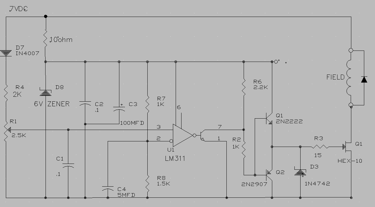

I have the main cutout diode shown in the hand drawn schematic earlier in this thread. I am wondering if it should go between the 7 VDC Rail at the top of Max's schematic and the car battery or somewhere else. I guess the .10 ohm resistor is probably more like 15 ohms, must have meant 10 ohms!
I am kind of wondering if the 3 reference input to the LM311 comparator is going to see enough voltage change relative to the 2 reference maybe it should go on the B+ side of the main diode or off of a .1 ohm resistor in series with the system load before the main diode?

Max's circuit is functionally a kind of switching regulator; the field control transistor is driven by a comparator IC so either on or off.
It's not constant frequency PWM, more like a hit-and-miss governor.
But the flywheel diode across the field coil means the field current should decay relatively slowly between kicks, keeping a pretty constant output voltage.
The power dissipation should be quite low.

Not sure I understand how a diode across the field will help the field, I thought it was just for protecting the electronics.
It does both.
The reason for a voltage spike if you switch off power to an inductor of some sort, without a flywheel diode or other protection, is that the current will continue flowing for some time - or at least try to. That can cause an extremely high voltage to build up for a fraction of a second.
The diode means the field current can keep circulating for some time. Probably only a fraction of a second with this, but I've seen big industrial motor or generator fields where you can see the current drop down over five seconds or more.
It means with this that the dynamo output voltage or current should not be fluctuating wildly as the transistor switches on and off, but more ramping up and down fractionally either side of the set voltage.

So I have come up with a first draft, Concerned about detecting current, a 20 mv change is going to be 2 Amps and that is at the limit of what the LM311 can detect. Also will the LM311 like I have it configured for current detection work that way? Perhaps I need an optical Isolated comparator?
FIRST DRAFT
