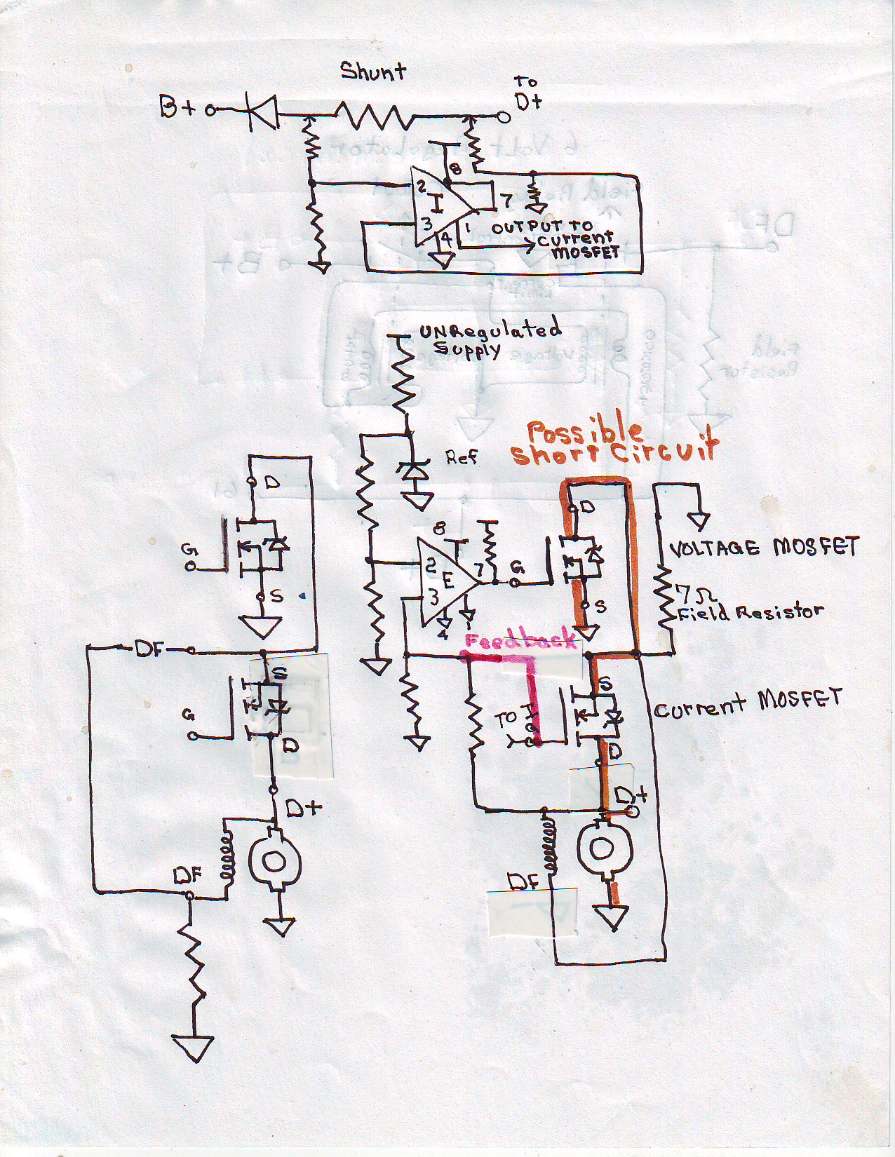

Don't have a design, sorry. But from my experience back in my early days the most usual faliure in a voltage regulator was the points/contacts burning up. The solenoids themselves and settings would be good but the contacts no longer would carry the load. So starting with a good regulator and putting mosfets after the contacts would take the load off of them since they would only be switching a very light load.
Yes, perhaps place a MOSFET across the DF to Ground contacts but it would need electronics to control it. Actually it could be inplace of the contacts and the contacts used to control it without electronics maybe?

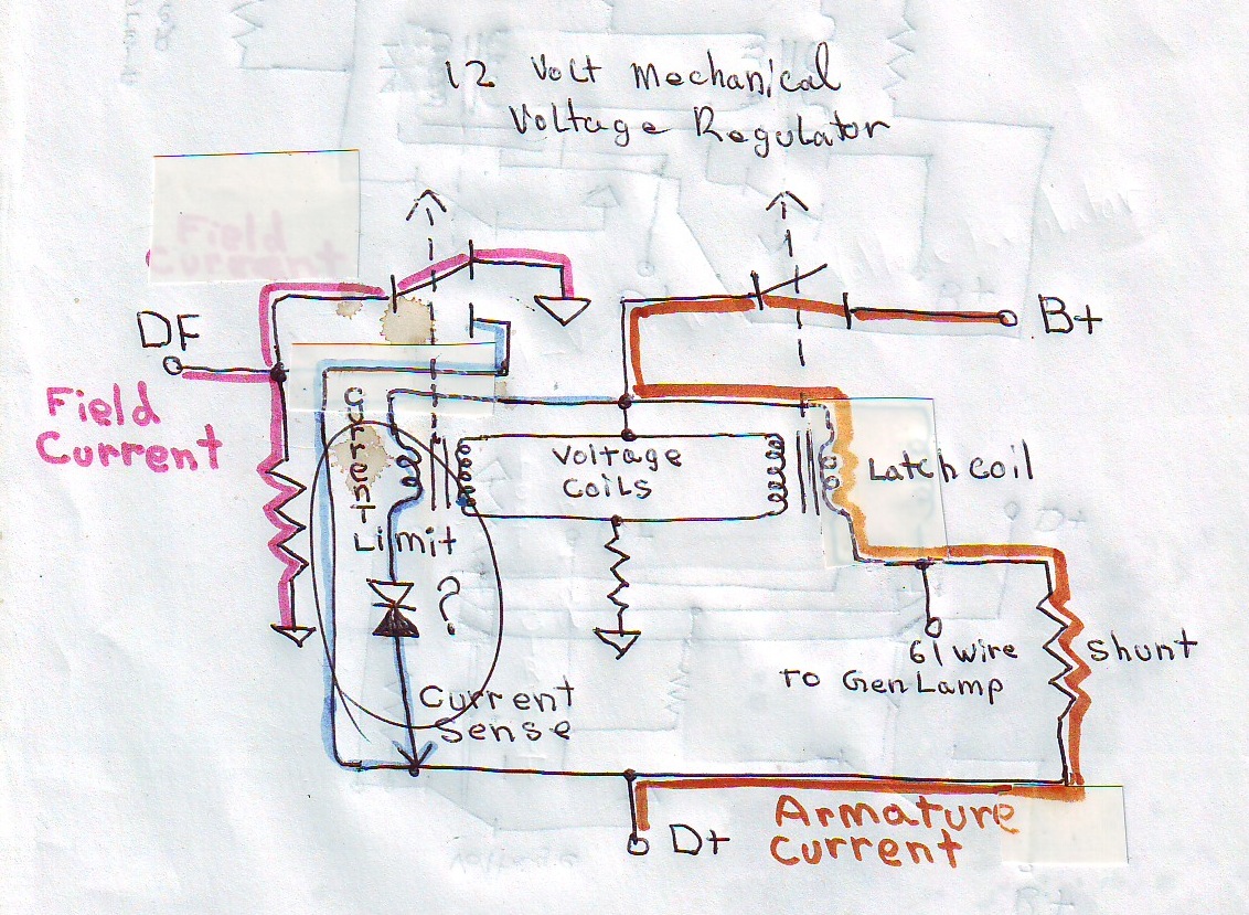

This has me looking at the schematic its for a 12 volt generator voltage regulator and I am a bit puzzled by it as I thought the diode was a field freewheel diode, It's apparently some kind of TVS Diode that protects against overload by increasing resistance. Does anyone know what the diode is? (Note! The 6 volt mechanical regulator does not have the diode it's just connected there i think.)
The diode is actually wired in series with the second coil on the field relay. I drew this trying to understand the operation better:
I'd guess it's to route all the current through the right-hand coil if the dynamo voltage is less than the battery voltage, so it the disconnect circuit is more sensitive.
The current winding on the left hand one is only needed at high current to prevent overload, while the right hand one needs to be sensitive to small variation.
The 6 volt mechanical voltage regulator did not have a diode and it was wired just a little different.

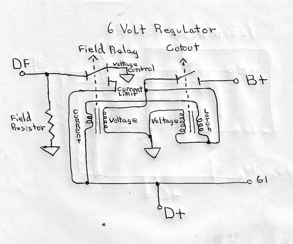

https://www.thesamba.com/vw/archives/manuals/voltage_regulator_diagram_closeup.jpg So in theory thinking positive to negative current flow. Current from the generator D+ goes through the current windings in series first then through the voltage windings that are configured in parallel. Looking at the close-up link the fields are opposite on the relays however the current and the voltage windings are all going the same direction within a coil. This means that the current and voltage coils work together to increase magnetism . The 6 volt mechanical regulator uses about 2 or 3 ohms for the resistor which is enough to cause overcharge by itself when the engine is revved. What happens to limit the current is the field relay starts to make the normally open DF to D+ connection which shorts out the field which limits the current.
If two MOSFETs were configured like the (common, Normally Open, Normally Closed) field relay on the mechanical regulator even with feedback control to prevent gating them both at the same time there is a risk of blowing both MOSFETs as together they provide a direct short to ground .
However the idea is interesting to me as it more fully emulates the Mechanical Design.

Probably due to the 6V having positive ground.
The 6 volt VW gen's are Neg Gnd. those small generators were very basic, simple, cheap and trouble unless everything in the electrical system was right. Actually I have a new respect for them now after trying to understand there exact operation. Not sure when they started using the diode, probably after the 12 volt generator.
I think the other contact just provides "flywheel" effect, to allow the field current to circulate until it dies off.
The flywheel diode does the same thing so no need with the electronics one.
The way mechanicals operate is the field relay only pulls in enough to open the NC connection at normal RPM's. They start hitting the Normally Open if revved up high. At least that is what I have seen when I removed the cover and watched them.

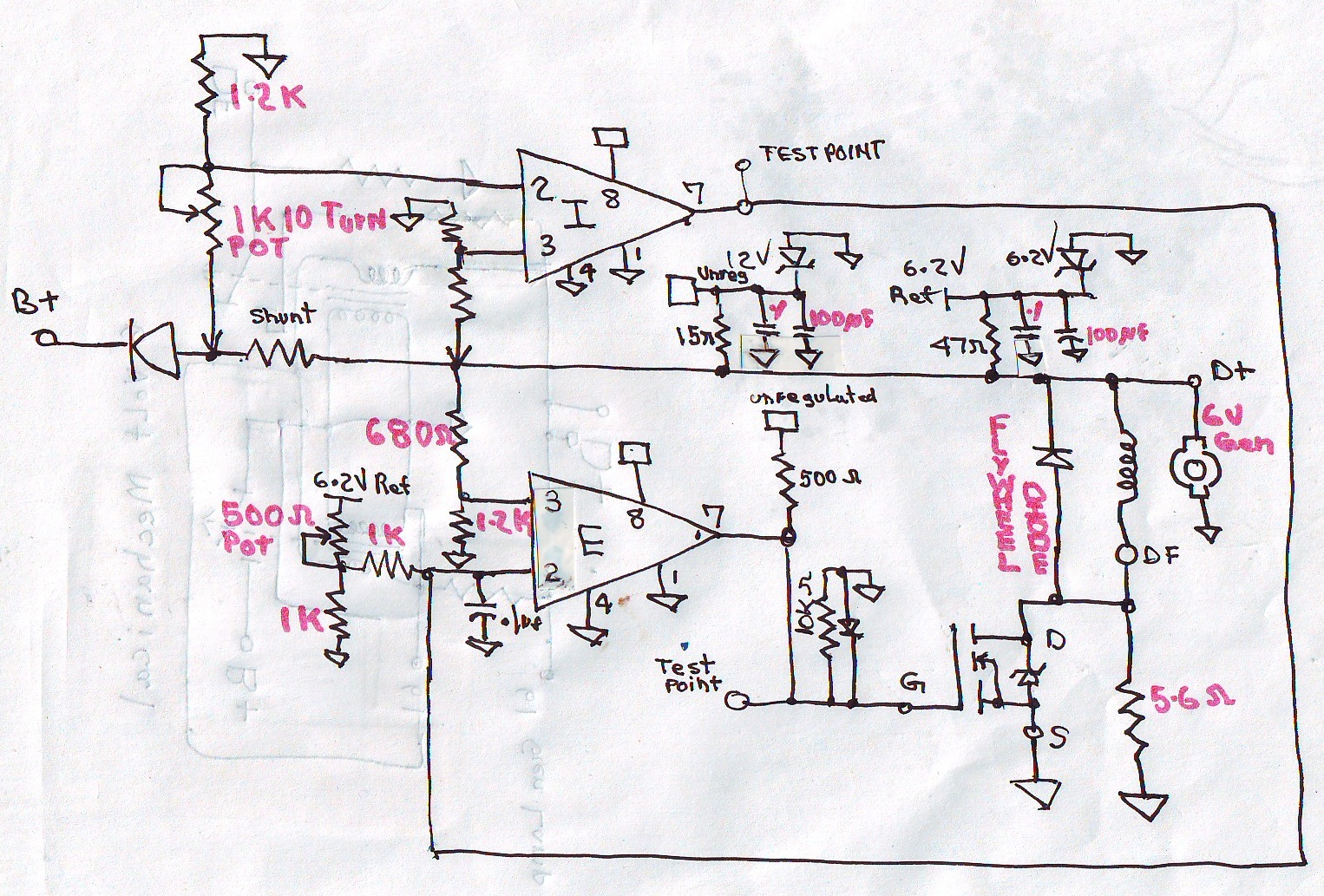

Here is a Schematic Draft for the next prototype it has the pull-up resistor. I think I will put all the resistors and capacitors on one board then the IC's, MOSFET and diodes on a second circuit board with terminals for the gnd, generator, shunt, output diode connections etc...
121012
Looks good, except I'd suggest the 0.1uF cap on pin 2 should be the other end of the 1K, so it takes noise off the reference divider but does not short the output of the other 311.
Possibly also add a low value resistor, 100R ? in series with the FET gate connection.
The 10K pulldown is redundant now it has a pull-up instead.
Looking at it and thinking about what will happen as it starts up, there is a possibility that the voltage control could see it as overvoltage, until the dynamo output exceeds the 6.2V zener level and the reference stabilises.
I'd swap the 680R feeding pin 3 for a 1.8V zener; that guarantees it will stay lower than pin 2 when it should and will also give fractionally better control.
Well, I think that you may have found the problem why it's not starting charging without help! Thanks!

Have you changed that resistor for a zener?
Three diodes in series should do temporarily, if you don't have a 1.8V one.
And, are you now using the pull-up version of the gate drive or still with the prototype that has a pull-down resistor? I think that's what will make a massive difference as it no longer needs the 311 to be powered to start charging.

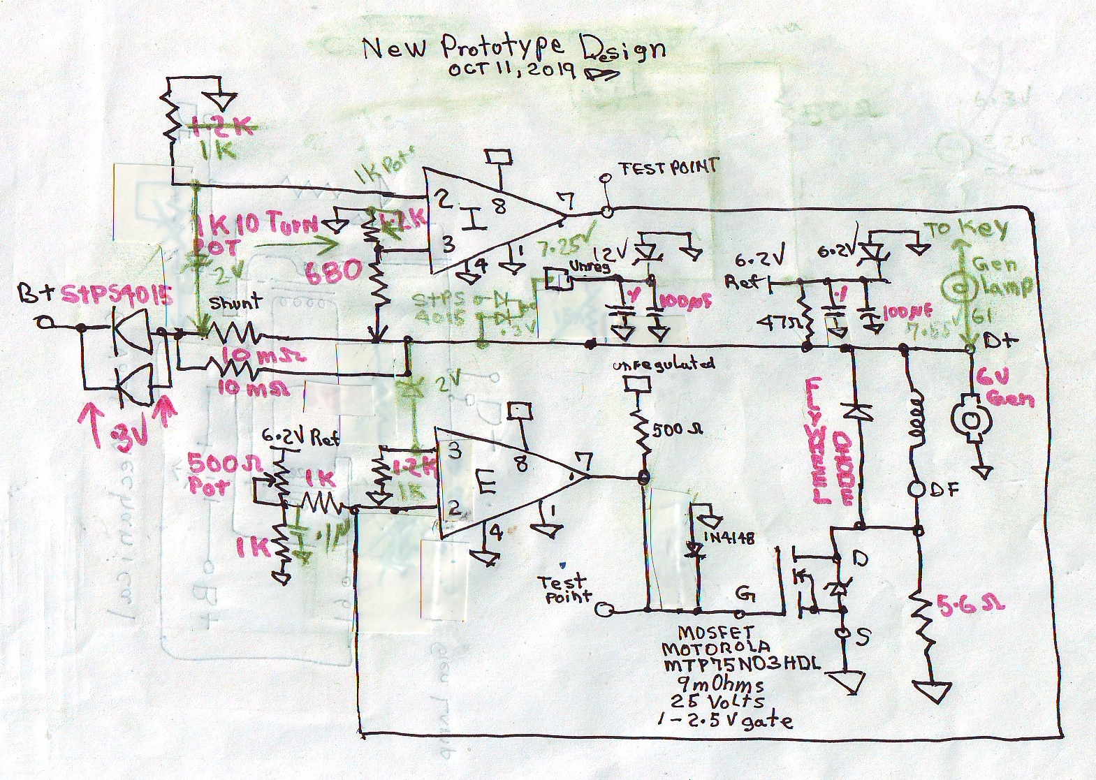

Oct. 10, 2019 Updated Original Design prototype 6 volt Neg Ground Automotive Generator Voltage Regulator:
OK, I'd not be too concerned about the initial start up function until the prototype is updated.
Yeah, it's starting beautifully though. The diode to the coil was most helpful then the 50 ohm resistor on the reference makes it start charging better too and once operational it's not dropping out. I suppose that it should be designed to run on 3 volts ideally.
Here is the next plan! Because the Unregulated is slightly lower than D+ voltage even with 2 volt Zeners, Voltage and Current inputs are only going to be 1.7 volts below supply voltage. Using a STPS4015 .3 volt diode from D+ to Unregulated will help and also adding another shunt.
Hi Dan,
The input to the voltage reg half needs the diode, as you have it drawn.
The current reg will not work with one diode like that as both inputs need to be proportional to the varying D+ voltage.
You would have to replace the 680R feeding the other input with a 2V zener as well.
To get the adjustment back, add a single diode and 1K from the zener to ground and put the pot across the diode.
That gives pin 3 a range of 0 to -.6V relative to the output side of the shunt, with much more precise control range.
Or just stay with all resistors in both legs of that; I can't figure out for sure at the moment what the voltages will do during start-up.
Adding yet another 2V zener in series with pin 7 may help if the modified circuit has a problem with the current sense part starting, it will prevent the voltage reg being clamped until the supply increases somewhat.
