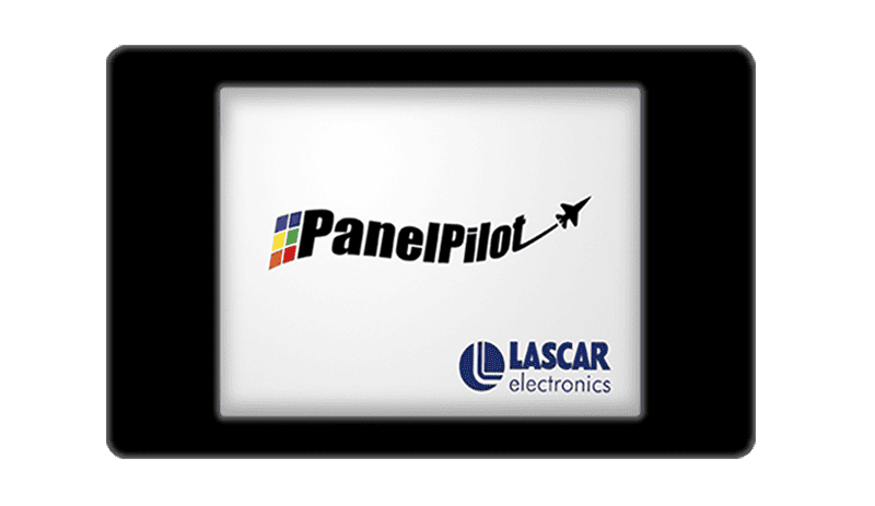

That's annoying, though I don't think I have seen a combined unit with a "floating" current input, other than via a separate current transformer or transducer.
You could use two separate meters, or a programmable dual input meter, with one of the little current transducers I linked to earlier on.
eg. We use some little Lascar SGD-24M configurable TFT meters for various things, they are very convenient.
You can configure them for digital, bargraph, "analog" needle etc. and whatever colours and scale labels you like.
