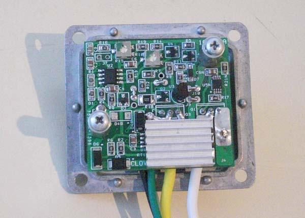

I found a little more information about the Clover Systems regulator, which no longer is available, as far as I can tell.
From the DRM Electronic Dynamo Regulator INSTRUCTION MANUAL:
In the DRM, the output voltage of the generator is compared to a precision
voltage reference. When the generator output exceeds this reference, the
current to the field coils is cut off. This causes the generator output to fall.
When the output falls below the reference voltage, the field current is turned
back on. In this way, the field current is modulated at a rate of 50 – 125 Hz.
These rapid changes are smoothed out by the inductance of the field coils, thus
maintaining a constant output voltage.
Current limiting is accomplished in the same way. Output current is sensed
with a Hall-Effect device that detects the magnetic field created by the output
current. When the output current exceeds a preset limit, the field current is
turned off. Just as with the voltage regulation, the field current is modulated to
maintain a constant output current.
Instead of a cut-out relay, DRM uses a MOSFET “ideal diode”, which is much
more efficient than Schottky diodes. Power is supplied whenever the dynamo
output voltage is greater than the battery voltage, rather than a pre-set voltage as
in the mechanical regulator.
So, they used a Hall-Effect current sensor and a MOSFET “ideal diode”.

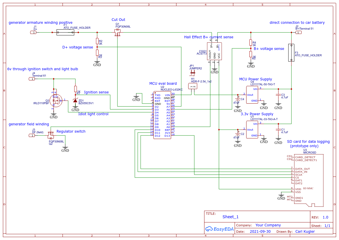

Hello everyone,
I got pulled off on some other projects (a couple even paying!), but now I am turning my attention back to this. I'll try to jump start the discussion by posting a schematic:
I have shared the EasyEDA project: https://oshwlab.com/carlk3/volt-reg
I am interested in your thoughts on this:
  • Why won't it work?
  • How can I make it more robust? Specifically, in the face of:
    • Electrical noise
    • Heat
    • Vibration
    • Dummies with 12v jumper cables
    • Batteries falling through rust holes and shorting out
  • How can I make it easier to build? Should I get a PCB made? Switch to SMT components (at least for simple parts), and have the SMT components populated?
  • I was just guessing at a lot of the part selections and component values.
This is intended to be a prototype, so I'm using an evaluation board for the MCU (gives me the ability to program and debug over a USB cable), and I've tried sticking an SD card on there for data logging so I can gather some data about the performance of the prototype on the road. Also, the MCU can easily go down to µA or nA in its sleep modes, and can run from a 1.71 V to 3.6 V power supply, but the NUCLEO-L412KB demo board has different needs, so the "production" version will probably need the power supplies reworked. I imagine I'll have some significant parasitic current draw with those LD1117s connected to the car battery all the time.
You need to look at the gate drive for Q2; as it is, it can never turn on - the gate needs to be a few volts positive of the source when on & equal to the source when off.
Possibly use a P channel FET plus a smaller transistor switching the gate to ground, & pullup resistor to source?
It will also need a diode from J3 to D+, a "flywheel diode" across the field coil output, to avoid damage to Q1. Preferably a big schottky that can stand the field current.
To reduce standby power, you could use a regulator that has a shutdown pin to power all the non-MCU stuff? Or add another P channel FET in the power connection from the MCU reg to the battery sense and other reg, so they can be shut off.

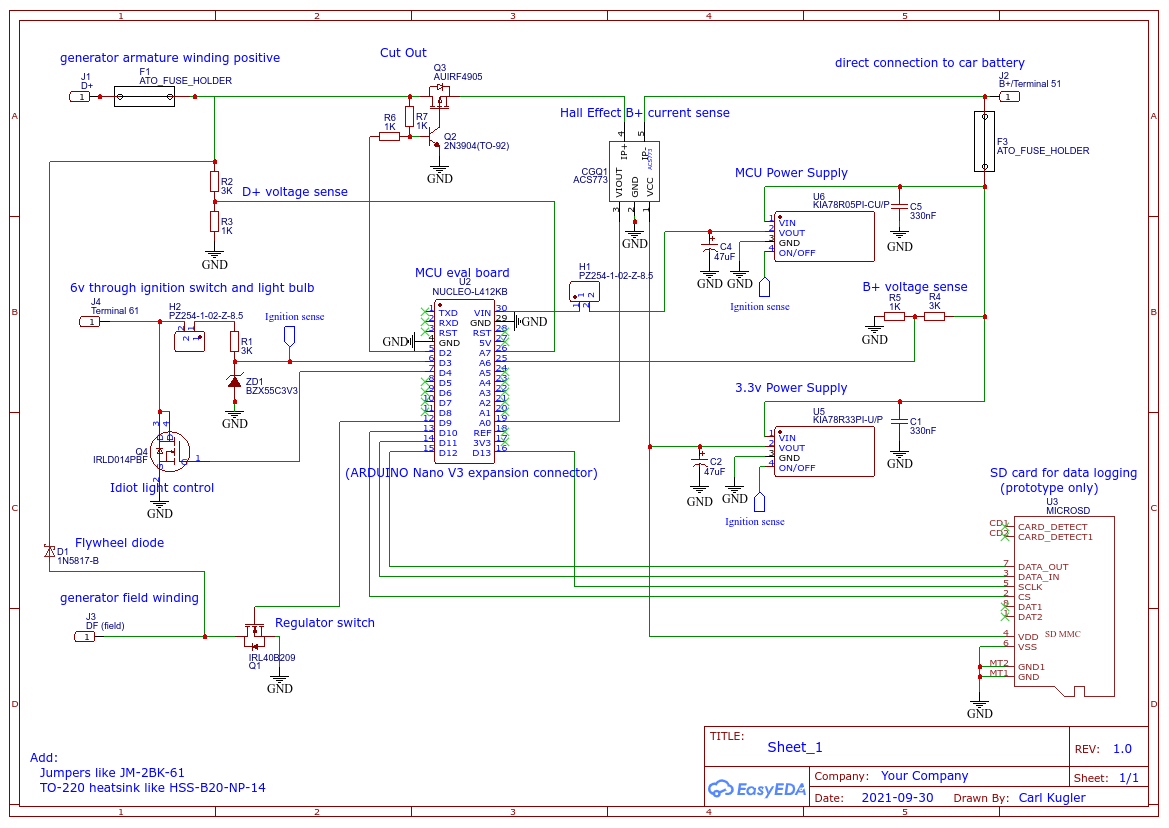

Thanks! How's this, then?
(Latest version is at https://oshwlab.com/carlk3/volt-reg)
The quiescent current of the LD1117s is 5-10mA, which isn't horrible for the prototype, but reducing it would be nice.
Or, maybe I could move all the ground connections for the power supplies and the B+ voltage sense to an N channel FET gated by the ignition switch?
Of course, that might affect the B+ voltage sense accuracy. Maybe I could double (or more?) the resistances in the voltage divider and leave it connected straight to B+? Maybe add a filter cap? I guess I need to consider what the ADC in the MCU is referencing to.
That looks OK, but I forgot about the FET diode - a single one as it is arranged will allow reverse current from the battery to the dynamo..
You would have to use two back-to-back (sources and gates commoned) for total isolation, or just reverse source and drain - MOSFETS conduct in both directions, as long as the gate-source voltage is present. That would never cut off the dynamo output from the battery, but the field control should minimise any residual output.

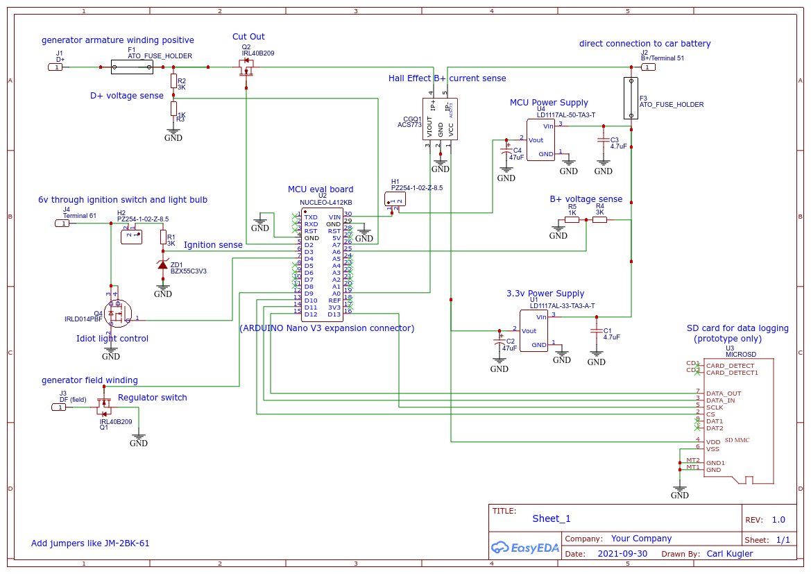

How does this look:

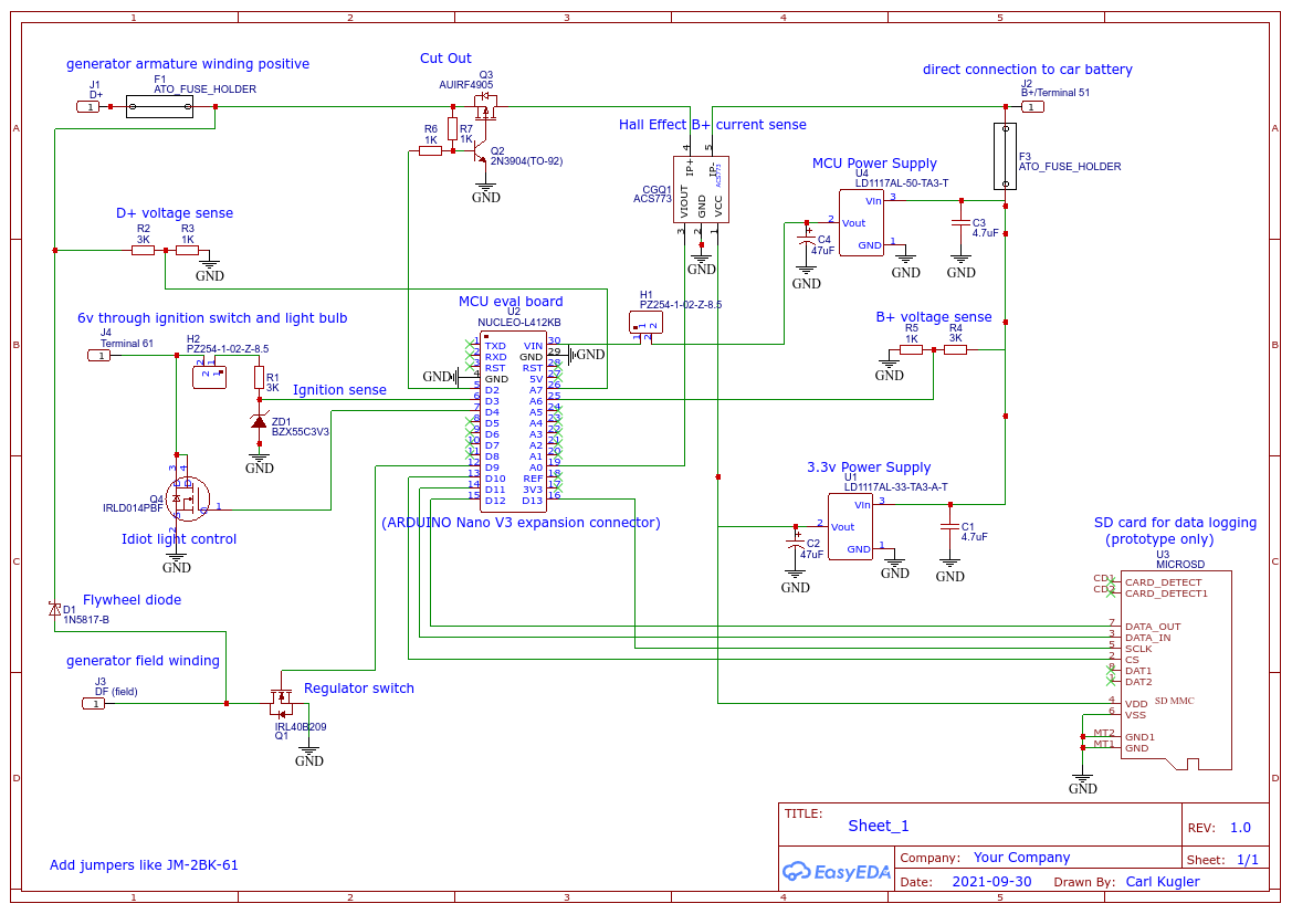

Thinking about this some more... Besides trying to make an "ideal diode", there is the notion of "cut in voltage". On my old regulator, the spec. is 6.2-6.8v. Of course, the voltage probably droops once it's cut in, but there is a huge amount of hysteresis: the reverse current (at cut out) is spec'd at 2-5.5 amps! (That reverse current is something I'd like to avoid.)
For my Optima AGM battery, the spec. for charging is "Alternator: 6.65 to 7.5 volts, no amperage limit."
At https://www.powerstream.com/SLA.htm, it says "Anything above 2.15 volts per cell will charge a lead acid battery, this is the voltage of the basic chemistry. This also means than nothing below 2.15 volts per cell will do any charging (12.9V for a 12V battery)", which would be 6.45v for a 6v lead-acid battery.
I really don't know how important "cut in voltage" is. Maybe I should add the second MOSFET. Have to think about the case of a very discharged battery that pulls down the voltage after cut in.
On a mechanical regulator, the cut-out contact allows current both ways. The cut-in voltage and reverse current system is to prevent the battery being drained by the dynamo at low revs.
You don't have that problem with the the electronic version.
I'd run the regulator switch from the MCU; the ignition & voltage sense signals are there regardless, so you can control the whole thing as needed then.
(Plus the regulator would turn off when you force the ignition lamp on, as shown).
Re. the protection you mentioned earlier, you could add relatively large VDRs (eg. Zenamics) at each external terminal to help suppress transient spikes.
I also just realised R7 is now in the wrong place, I only glanced at it last time. R7 should be to ground to hold the Q2 off with no signals, and the FET needs a resistor between gate and source to hold that off unless turned on.
You could add overvoltage protection there, to prevent a spike damaging the FET gate; a low value series resistor between Q2 and the gate and a zener across gate & source to clip the gate voltage; eg. 10V.
I remember from somewhere than 12V vehicle electronics are supposed to be rated to stand 60V transients!

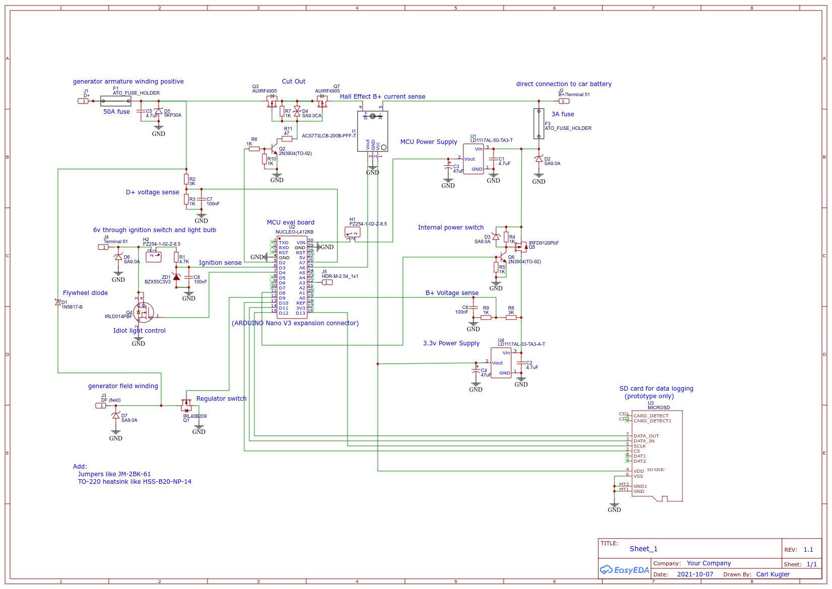

Also, I've been thinking that the D+ power must be dirty, dirty. I can watch the sparks fly from the carbon brushes on the commutator. And talk about inductive... I wonder if adding a capacitor or two from D+ to ground would help that situation? And maybe a TVS?
I think a common problem is the "current dump", which happens then the car is going down the highway and the battery decides to open up (or the terminal falls off, etc.) The alternator regulator is slow to respond and there is a big, long, high-voltage, high-current surge. Luckily, my generator is pretty anemic and can barely raise 25v on an open circuit with DF shorted to ground. And, from the point of view inside the regulator, we're in charge of regulating any surges!
OK; I was thinking the MCU power (and not the other reg) could be left on all the time & just put the MCU to sleep until the ignition was turned on to wake it.
