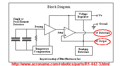

I use Eltec 442-3 pyroelectric sensor to detect a candle.

Hi WCZ,
You have not told us what your problem is.
Look carefully at the block diagram by the manufacturer, they have the output and reference pin wrong.

Actually, i have no idea on how to program the Eltec 442-3 sensor.
I need some idea on it.
Is it i can program it through A/D converter?
Extremely simple to use, this sensor requires no external components, only power and ground connections. The output is an analog signal (0-5V) which can be read by any microcontroller with a spare analog input pin.
The above is quoted from the Eltec 442-3 pyroelectric sensor description. You do not program the sensor. Instead you program the PIC A/D pin to read the output of the sensor and your software then decide on what to do next.
