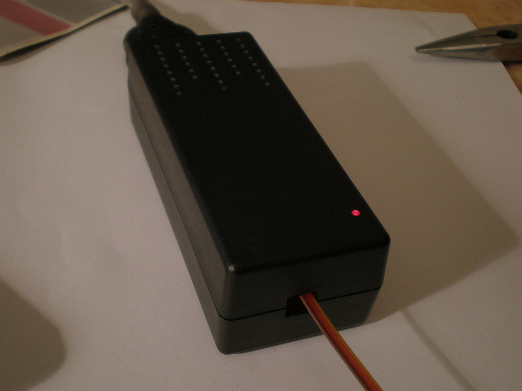

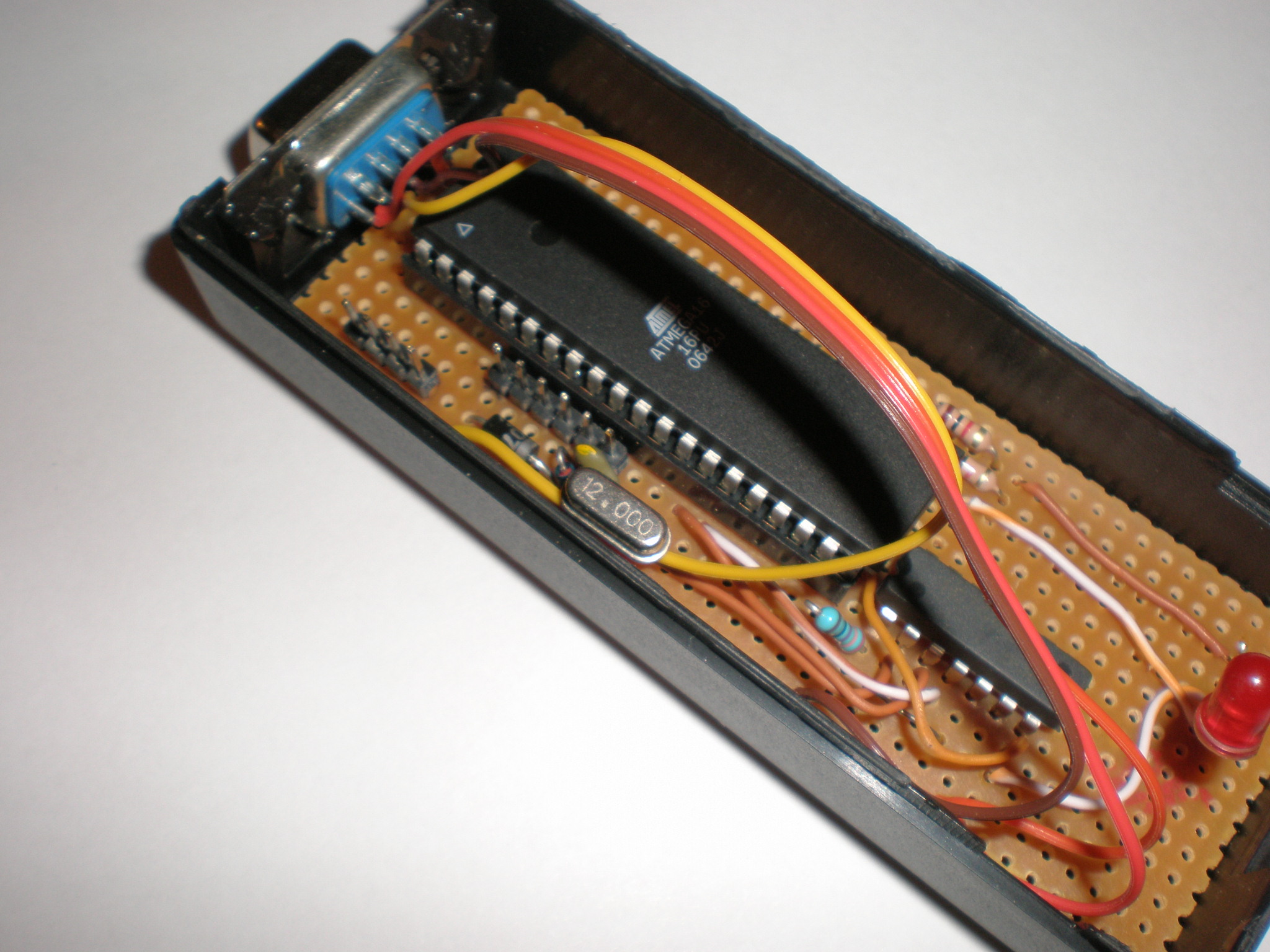

My challenge is to build it with only an ATMEGA16.
There is some chances i could reach the 2 Mhz sampling rate he has achieved, or even cross it. I am using inline assemble codes for the critical sampling loops. the rest of the program is written in standard winAVR C.
Last update
hello guys, here is what i've been up to, the hardware part is finished.. and guess what, I reached 3 MHz sampling rate with a 12MHz crystal, i could reach 4 MHz sampling rate with a 16Mhz crystal. I am actually storing 1000 samples before sending them to the PC.
I still didn't work on the triggering, but i don't worry about that part.
As for the the visual basic software that treat all this received data, here what i'll be getting into in the tomming weeks! (yes i work only the week-end since i started my summer training in that electronics company...)
One more detail, the whole is powered from the serial PORT, no need to external power. Also, it is actually connected to USB via a USB/SERIAL cable.
