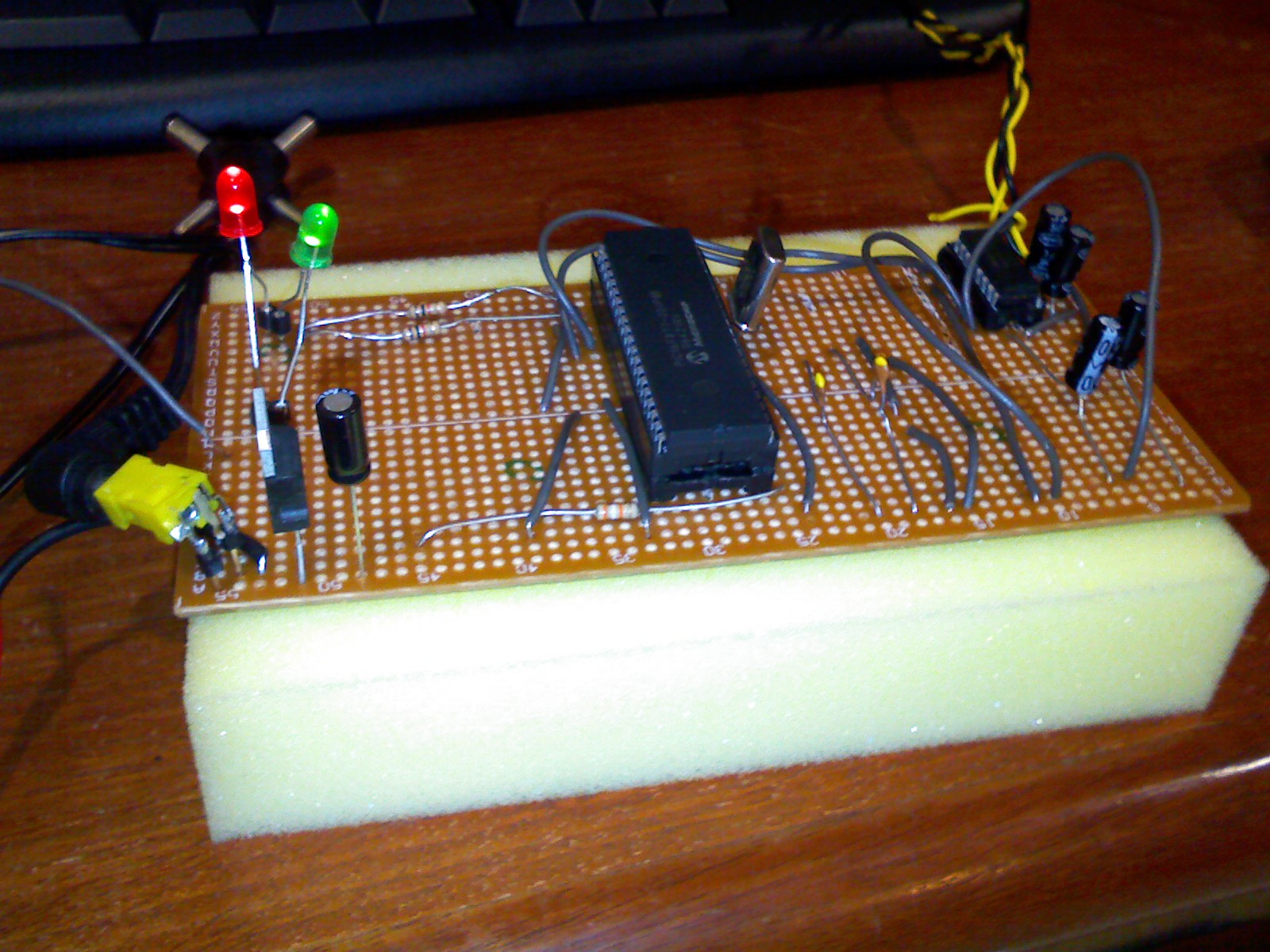

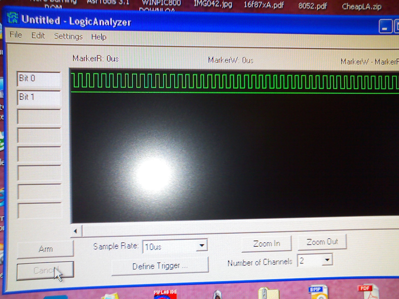

i've build the simple L.A. in just a few days and it is working well. the little disappointment for me is that it doesn't have a software side buffer to save more data.
I figured even if the PIC doesn't have enough resource to store data in it, it could be done at PC side software to store down the data for later analysis. But there's no source code provided for PC side application, so nothing much can be done.

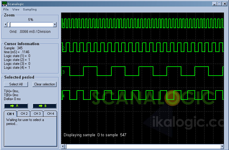

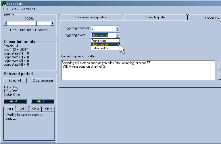

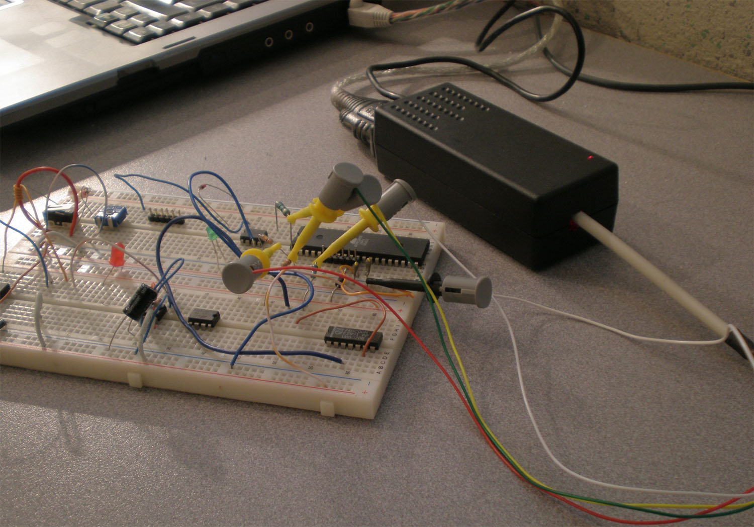

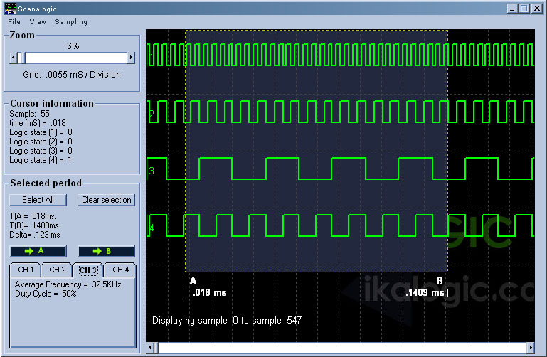

I'm keeping you guys informed of the progress..
I think the hardware and micro-controller part is finished once and for all (just for this first version ;) )
The software is almost done, a beta version is coming out soon. I still have to write a little help (maybe it'll be online on my website though..), and allow users to export bitmap screen shots, and save/open data for later analysis.
I've been testing it all the week-end and it was a lot of fun playing with my brand new logic analyzer! i've posted some screen-shots of one testing session..
I'm not sure if the first beta version will incorporate decoding UART/SPI/I2C data buses..
Waiting for your comments! :)
