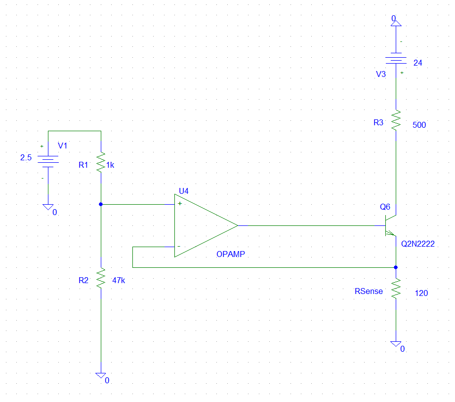

Hi guys,
Please help me in this. I am designing a voltage controlled current output circuit. It has an input from 0 to 2.5V and it should give current outputs between 0 - 20mA. I was able to do that with a circuit that looks like:
https://www.flickr.com/photos/41126610@N06/5835196217/in/photostream

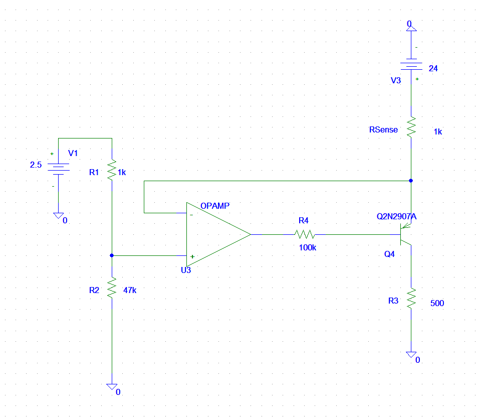

However, I realise what I actually need is something that looks like:
https://www.flickr.com/photos/41126610@N06/5835730028/in/photostream
where the transistor is sinking the output current into R3(Output Load) instead of sourcing from it.
Circuit number 2 however, doesn't work when I tried modeling it with Pspice. It's been giving me such a headache.
Can anybody help me on whether there're any obvious mistakes I've made in the circuit? Also, some explanations why it doesn't work and some suggestions for a better voltage controlled current source circuit would be extremely appreciated.

First off, you should post your circuits here, not on a third party site - click on 'Go Advanced', and 'Manage Attachments'.
But for your second circuit the input needs referencing to the +ve supply, not 0V.
Sorry about the third party site picture. I have attached the same pictures here now.
Thanks Nigel for your reply. May I ask what it means by 'referencing to the +ve supply'? Does it mean my input 2.5V should be +2.5V relative to the +24V supply?
May I also ask why the first circuit works but the second doesnt?
It should be -2.5V relative to the +24V supply.
Because the first one shared a common reference point (0V), the second one didn't (it tried to use 0V and +24V as a 'common' reference).
As Nigel noted your reference voltage is not correct. Think about it. You need the reference voltage to appear across RSense which is floating at 24V above ground. Thus the reference voltage at the op amp + input needs to be 24V minus Vrsense.
I agree with TR that a Howland circuit should work well for this requirement. A typical op amp should be able to provide the desired 20mA directly.
