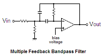

Maybe you are making a bandpass filter with a lowpass filter plus a highpass filter. It will have a low Q and will cut the center frequency if you try to make its Q as high as possibble which is not very high.
For a high Q bandpass filter you shoulf look in google at Multiple Feedback Bandpass Filter.

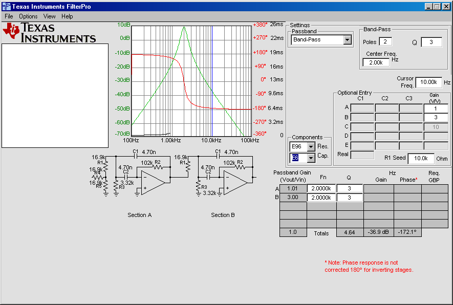

Yes, by incorporating a lowpass filter and a highpass filter to create the bandpass. If bandwidth can be any length, how do you keep the center frequency at 2000 Hz?
Here is how I would do it ;)
By definition it's half way between the lowpass roll-off and the highpass roll-off.
Why is that confusing?

A good example of a modern bandpass filter is the one posted by audioguru, but again we dont know yet if you can use an op amp with your design. The design formulas are as follows:
R1=Q/(G*2*pi*f*C) [input resistor]
R2=Q/((2*Q^2-G)*2*pi*f*C) [one side grounded resistor]
R3=Q/(pi*f*C) [feedback resistor]
where
Q is the desired Q of the circuit (equal to center frequency divided by the bandwidth),
G is the required passband gain,
f is the center frequency (2000 in your case),
C is the capacitance of both C1 and C2 (both caps, for example 0.01uf each).
To use those formulas you pick a value of C say 0.01uf and a value for Q and a value for the passband gain G. Q affects the sharpness of the filter, G affects the gain at 2000Hz.
Since those formulas are for a circuit containing a perfect ideal op amp sometimes you have to adjust the value of f a little bit to get a better circuit for a real life op amp ie making f equal to 2050 would probably get you closer to the actual real circuit for use at 2000Hz. In any case however it's a good idea to do a simulation before deciding on the final values.
Note that the bandwidth is the two sided bandwidth so for example with a center frequency of 2000 and bandwidth of 200 that would mean 100Hz on either side of the center frequency to the -3db point. Since Q=f/bandwidth that means Q=2000/200=10 for this example.
