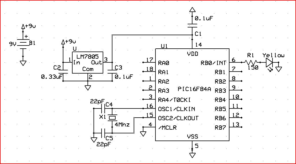

When i build this program it built successfully. Then, i programmed it into a 16F84a but when i place an led in RB0 with correct resistor nothing happen!
I am trouble shooting my circuit
Q>how i know if the crystal i bought 4MHz is working or not?

The program can't get much simpler. If the LED is wired correctly, the MCU has 5V power and ground connected and your MCLR pin is pulled high with a 10K to 33K resistor then it has to work.
**broken link removed** you can have a look at to compare with how yours is set up.

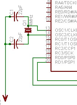

Your crystal needs two (typically) 22pF loading capacitors to work properly. Wire them like this (not a 16F84, but same idea):
I change the codes you suggested still not working.
I will post the schematic that i am following
There's the problem. Like I said previously, MCLR must be pulled high with a resistor. Your schematic shows it pulled low. When MCLR is held low the PIC is in RESET, and halted. No program runs with MCLR pulled low like that.
Q> What you mean by pulled high and pulled low and when do i use pulled high or pulled low?
Wow it worked i connected MCLR to 5V and it worked i guess that was the problem.
Thanks futz for giving me guide :)
  • Like
Reactions: 3v0
