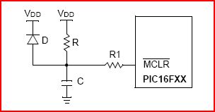

I was under this assumption as well but it seems that later pics shouldn't have MCLR connected direct to Vdd.
From the 16F876A data sheet,
Figure 14-5 in the datasheet gives an upper bound for the value for one of the resistors and a lower bound for the value of the other, but doesn't seem to indicate what the capacitor value should be. Any ideas? or have I just not looked carefully enough?
I think setting a resistor <40k is neccesary between MCLR and vdd now.
I searched the datasheet of 16F84A as david said a capacitor must be included and also i found out that another resistor and diode is needed.
Q> What is the value of C and diode that i must used?

The diode and second resistor isn't really necessary. Just put a 22K or 33K (or thereabouts) resistor between MCLR and VDD.
A 0.1uF capacitor between VDD and VSS is a good idea. Place it as close to the chip as possible.
The description under the data sheet illustration you attached indicates R is anything <40K, (10K is typical, I believe), and R1 100<R>1K. The cap is usually .o1 uF, and the diode can be a small signal, such as 1N4001.

I have question how do i know the value of capacitor?
I mean is there is a way i can calculate it.
If there is a way please show me.
