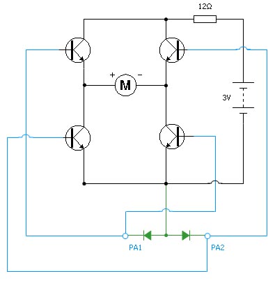

Okay, given the current information, I've drawn up another schematic which is hopefully closer to what it should look like now. I'm not sure if I have connected the ground (green) correctly; I tried to connect it such that when PA1 is high and PA2 is low, PA2 acts as ground for PA1, and vice verca. That prevents a short-circuit if PA1 and PA2 are ever both driven high.
Any comments are welcome.
The transistor which seems most appropriate is the BC337-16 model transistor. Maplin doesn't provide a full data sheet, but the Ic is 500mA; I'm not entirely sure how to interpret the rest of the information.

The upper transistors in your H-bridge are emitter-followers with a 0.7V or more voltage loss.
Then the 3V motor gets only 2.1V minus the voltage loss across the 12 ohms resistor.
The diodes do nothing.
But without them there would be a short circuit between the PA1 and PA2 pins, and virtually no current would flow through the BJTs since that's the more resistive path.
Is there a way I could avoid this? Or will I simply need to increase the voltage supply?
I had a feeling it was too good to be true that I may have finally found a solution...
